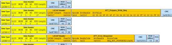

  • Just tried prepare write with 1.4,
    our BLE device is in server role, iOS App is client role,
    obviously, this release does not support prepare write in server role.
    (server could not fulfill prepare write request)
