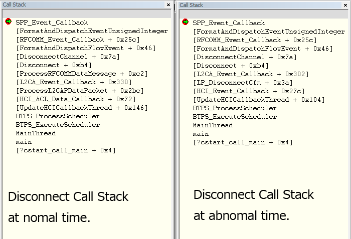

  • Hello Stonestreet One,
    I doubted that a receiver device automatically sent a port close command. So I researched the Call Satck calling the SPP port close callback function.The left side of the following image is the Call Stack of the time sending manually port close command, and the right side is the time of the data send error. What do you think about this difference?
    Naofumi.
  • Hello Naofumi,
    What I meant was the port close was triggered by the remote device. You are right, it is not an explicit port close but the remote device most likely has stopped responding. This results in the link supervision timeout getting triggered which in turn shows up as an HCI disconnect event with a timeout. This must be the HCI Event callback in the error case. Although it was triggered by an error, this looks like a graceful shutdown on our side. To confirm that, you can try connecting to another remote device in a clean state and we should be able to connect. We can also try to trap the HCI Event and see what the error code was in the error case. I will send you some code when I get in to work tomorrow so that you can register an HCI callback and print out if that was a disconnect event and what the reason was.
