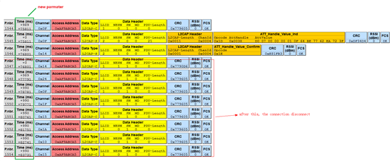

After a connection between an iOS device and a BLE device was established, an update for connection parameter was sent to save more battery power. The update was successful. And then some requests sent by the iOS was not responded by the BLE device from time to time, and the connection would be cut off when timed out thereafter.
Is this a known bug for iOS 6? Is there any work-around?

    In the problem, the parameter update has been done successfully( where the interval has been changed to 1 second from default value), and communication went on with the new parameters, as sniffed below:
    However, the following problem occurred during:
    The picture shows that, with the new parameters, the Master sent requests in several continuous connect events but the Slave would not respond, leading to termination of communication.
    Is this problem the same as the one you encountered? Would you please elaborate on your solution?

    In my case, the LL_CONNECTION_UPDATE_REQ was received, but no communication occurred after the connInstant when the new parameters were to take effect.
    The key to my work-around is the realization that the connection parameter update never fails in the absence of other data on the link.  You just need some mechanism that tells both peers not to send any data until the parameter update has completed.
