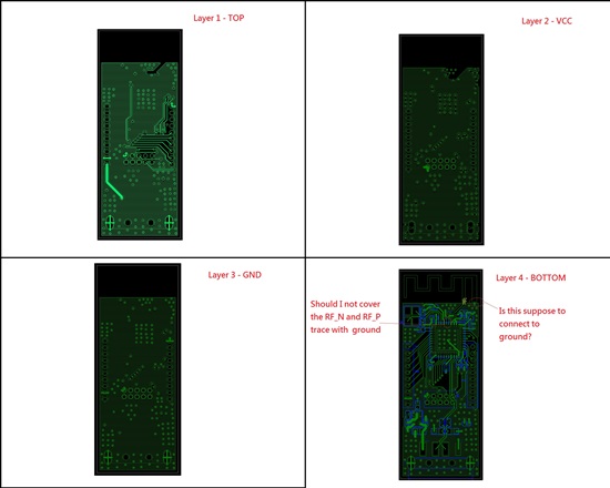

Currently we are working on a project using CC2540 as a USB dongle to connect to a PC to receive UART data from a device thru wireless BLE. However we encounter a problem when verifying the design.
We use the keyfob application program on a iPhone 4S/iPad Mini trying to connect to our custom made CC2540 USB dongle. When pressing scan key on the iPhone app, it will sometimes successfully discover device and show the "disconnect" button. However, most of the time the app will remain in the "connecting" stage.
It seems to me that it might be problem with RF antenna as I can successfully program and erase CC2540 using the CC debugger tool. So I assume that hardware on the digital side is ok.
I implemented the inverted F antenna as application note AN043 suggested. I've also attached my schematic and gerber. Any suggestion on how I can verify and confirm that it's an antenna problem will be welcome. Also please do help comment on my layout as this is my first time designing a RF board.

  • Steve,
    From an RF standpoint, the layout looks okay (at least what I could see in the picture).
    The end of the antenna that you point out needs to be connected to the ground plane. Also, there should be a solid ground plane under the RF, which you do maintain in layer 3.
    The Layout Review Technique app note (http://www.ti.com/litv/pdf/swra367a) has a ton of good info on considerations for RF layout.

  • Hi Chatto,
    After spending some time to read and understand the application note AN098 and AN068, I have a question. What's the impedence needed on the differential pair of RF signal to the balanced port of the Murata Balun? The reason I ask this is that I have the change the stack height (to 1mm) of my pcb board due to mechanical constrains.
    BR,
    Steve
  • The differential pair of RF signal to the balanced port of the Murata Balun is matched to the output impedance of the chip stated in the CC2540 datasheet.
    Using a chip balun gives you a distinct advantage in your case, it is not as susceptible to layer stacking height as a discrete balun would be. I would recommend having provisions for a shunt component across the balanced inputs of the balun. You should be okay with the chip balun being symmetrical and close to the RF pins of the CC2540.
  • Hi Chatto,
    Problemed solved! It turns out that I didnt solder the Balun well so that there are so interference with the RF. The custom boards I got back from the SMT factory worked well!! Thanks for everyone's help in this post!

    where is the Pi RF network between the balun and antenna?
    Without that , the antenna and the wire to it may  not be Caliban to 50 ohm and you may have a TX/RX problem.
    -Nissim
  • When using a chip balun, the Pi or T filter/matching network is integrated into the chip balun. The unbalanced output impedance of the chip balun is 50 ohms.
    However, it is good practice to have a shunt and series element at the antenna feed point to ensure that if there is some impedance mismatch at the antenna feed point, one can match using the passives.
