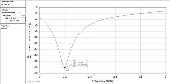

  • All,
    The IFA described in in AN043 was analyzed with Sonnet Lite EM software.  This SW is provided free of charge from Sonnet.
    A 3D view of the IFA analyzed is shown below:
    The predicted S11 response is next.  The best S11 was at 2.2 GHz rather than the desired 2.45 GHz.  This could be due to many factors such as the exact location of the shunt trace ground via, Sonnet box size, cover distances, thickness of air layers above and below PCB (FR4) layer, etc.  I'm not certain exactly how the EM simulation shown in AN043 was setup.
    Sonnet generates S-parameter data after the simulation is complete and saves to a file if desired.  The predicted S-parameter data can easily be matched at 2.45 GHz with lumped components.  Sonnet provides a text editor so ideal components can be simulated along with the predicted S-parameter data.  Below I show the schematic simulated in Sonnet.  I used Agilent ADS to show the schematic view for clarity.  Notice I added a series 1.2 pF cap and a shunt 0.4 pF from the 50 ohm point.  The "S1P" data box uses the EM generated S-parameter data.  A better simulation would include ESL and ESR for the caps.
    The new S11 plot (antenna matching network + EM simulated IFA) is shown below.  Notice the best S11 dip is now at 2.45 GHz.

    What thickness board did you assume in your test.  The AN043 references the CC2511 dongle design.  If you look at the readme associated with the gerber zip they indicate what appears to me to be a non standard thickness of FR4.  What's also interesting is we have a CC2540 dongle and the board thickness is 0.062.  Posts I've seen on this forum indicate that dielectric thickness must be accounted for in antenna tuning.
    The difference between matched and unmatched appears to be night and day.  It looks like the unmatched would virtually not work at all S11 is so high at 2.45G.
    Did you try to tune the IFA you simulated prior to matching it?  Seems to me that if you can move the resonance as close as possible to 2.45G prior to matching the better performance you'd get from the antenna.  Would be interesting to see the simulated differences of a 'as is' matched (the simulation you posted) and the 'as is tuned' then matched.

    The 3D view shows the IFA on layer 1 and the ground rectangle on layer 2. You can also see the shunt line gnd via and the via port connected to the 50 ohm feed line.
    I used a PCB thickness of 1 mm per the readme text file from TI.  The PCB is actually 4 layers thick but Sonnet Lite only allows 2 metal layers. Sonnet Pro was used to simulate the IFA with the gnd rectangle on layer 2 but with a layer thickness of 0.25 mm. Then the entire PCB thickness was set to 1mm. This was found not to make much of a difference to the resonant freq.
    The IFA freq can be increased by decreasing the overall length per Sonnet.
    Even if the IFA was resonant at 2.2GHz, it could still be used at 2.45 GHz ISM band if matched up.

    Thanks for the response.  Regarding the 2.2G resonance and matching.  I think what you're implying is that the matching/network antenna combo become the resonant circuit?  Lot's of good info for when I'm on the critical path and need to pick this kind of stuff up.
    Bryan
  • Bryan,
    Yes, that is correct -- the matching network and IFA make up the antenna.

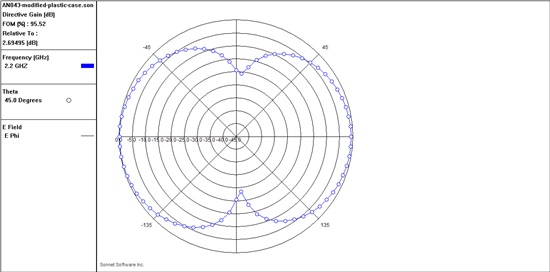

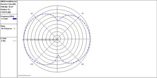

  • All,
    I had additional time to study this antenna (MIFA) design.  I was curious what the radiation patterns would look like with a plastic case over the antenna.  I used Sonnet Pro EM software to do this work -- the Pro version allows calculation and viewing of the radiation patterns.
    The plot below is for the antenna in free space (XY plane).  Compare to figure 8 of AN043.  The plot is at 2.2 GHz rather than 2.45 GHz since this simulation had the best match (S11) at 2.2 GHz.  I understand that the edge of the PCB tunes the antenna slightly but i haven't simulated that case yet.  The radiation pattern at 2.45 GHz was not that much different even with the degraded S11.  As I wrote previously, a simple matching network "pulls" the antenna match to 2.45 GHz.
    The next plot was from a simulation with a 0.5 mm plastic case 2.5 mm above and below the antenna PCB.  The dielectric stack-up was then 2.5 mm of air, then 0.5 mm of plastic (Er=2.4) and then 65 mm of air above and below the PCB.  The plot looks nearly identical except the predicted gain increased slightly.  Both of these plots are relative to the max gain shown to the left of the plot.
    If you have any issues using this antenna design notice there are angles where the gain drops 20 to 25 dB.  Both of these plots are set to 5 dB/div just as was done in AN043.  Your system design must accept these antenna gain nulls to be sucessful.
