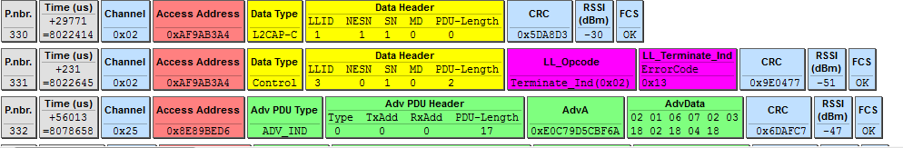

I use Packet sniffer to capture the data to debug my codes for disconnection after connected as below. Can anyone help me to understand the error codes mean? Thanks. CK
Hi Cheuk,
The error codes are specified in the Core Version 4.0. LL Terminate Ind can be found on page 2213, the error codes, as referenced in the section about Terminate Ind, on page 585.
The error-codes are also defined in ll.h in the 1.3 stack.
