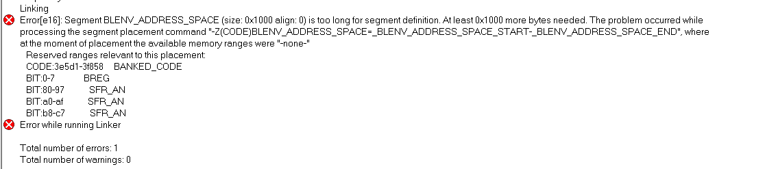

    I call it in the  osalInitTasks() and it gives me a linking error! I don't understand why!
    void osalInitTasks()
    memorySPIinit();
    It gives "Linking Error[e27]: Entry "SD_Command::?relay" in module OSAL_SimpleBLEPeripheral ( C:\Texas  ..... ..... .... "

    I do not get it - how did you manage to call any function despite linker error? I thought IAR simply should not download.
    128K device may be too small to house both stack and FatFS code. Try to crank compiler optimisation up, if possible, or maybe use 256K part. It's been years since I have worked with 8051s under IAR, maybe there are some banking tricks one could use to optimize code placement.
