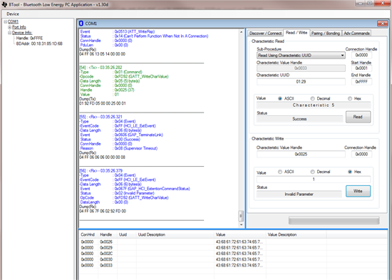

I can compile - with no errors, Click Download and Debug in IAR, get as far as HAL_BOARD_INIT [in main()], run the code and Connect to device using BTool.
This is using the SRF05EB v1.8 with Evaluation Module CC2540DK_EM, connected to my PC/IAR via USB....
When I run the code, I can see 'Advertising' and using BTool I can connect and see 'Connected' on the LCD.
I can then query by UUID and extract Attribute-descriptions as follows (and this works)... Reading Characteristic UUID of 0x2901

I can repeat the above as many times as I want and get the above set of results....

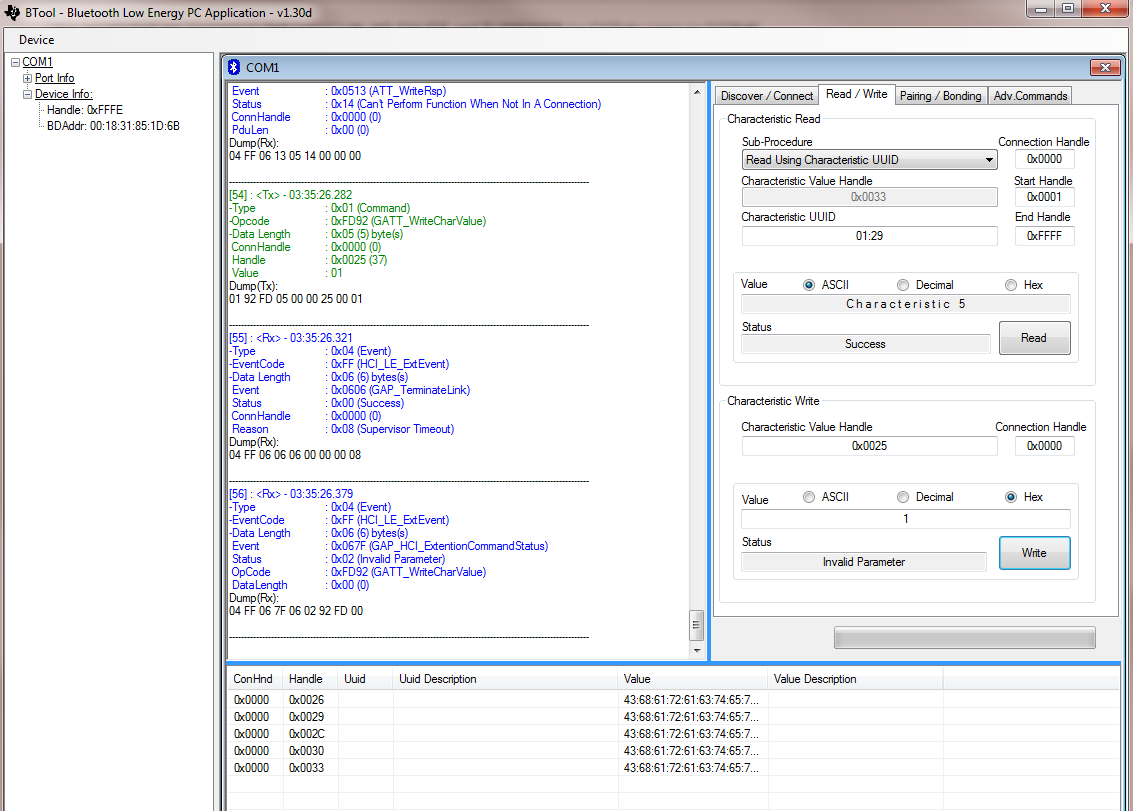

When I attempt to 'WRITE Characteristic' to 0x0025 (change value of Characteristic 1), the system locks up.

    I have figured out at least one of my problems......
    During an update from v1.2 to v1.3  TI have introduced bugs into the BTool software.
    It was, still is locking up when I send a character to 0x0025. Running the same code on Btool v1.2 doesn't.
    I have replicated exactly the same procedures described above and reverting to BTool v1.2 has solved this particular problem - of locking up...
    Gone back to BTool v1.3 and it locks up again......
