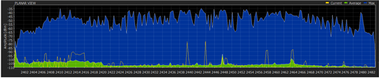

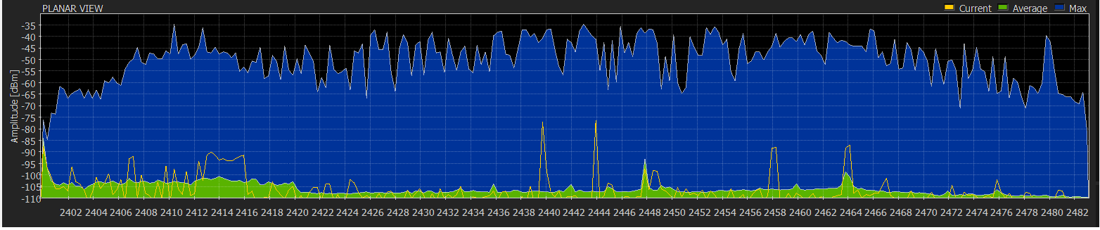

I have an own application to test this. I will send you wireless spectrum and commands tomorrow. Anyway there is nothing to see because you can't see there any peaks produced cc256x.

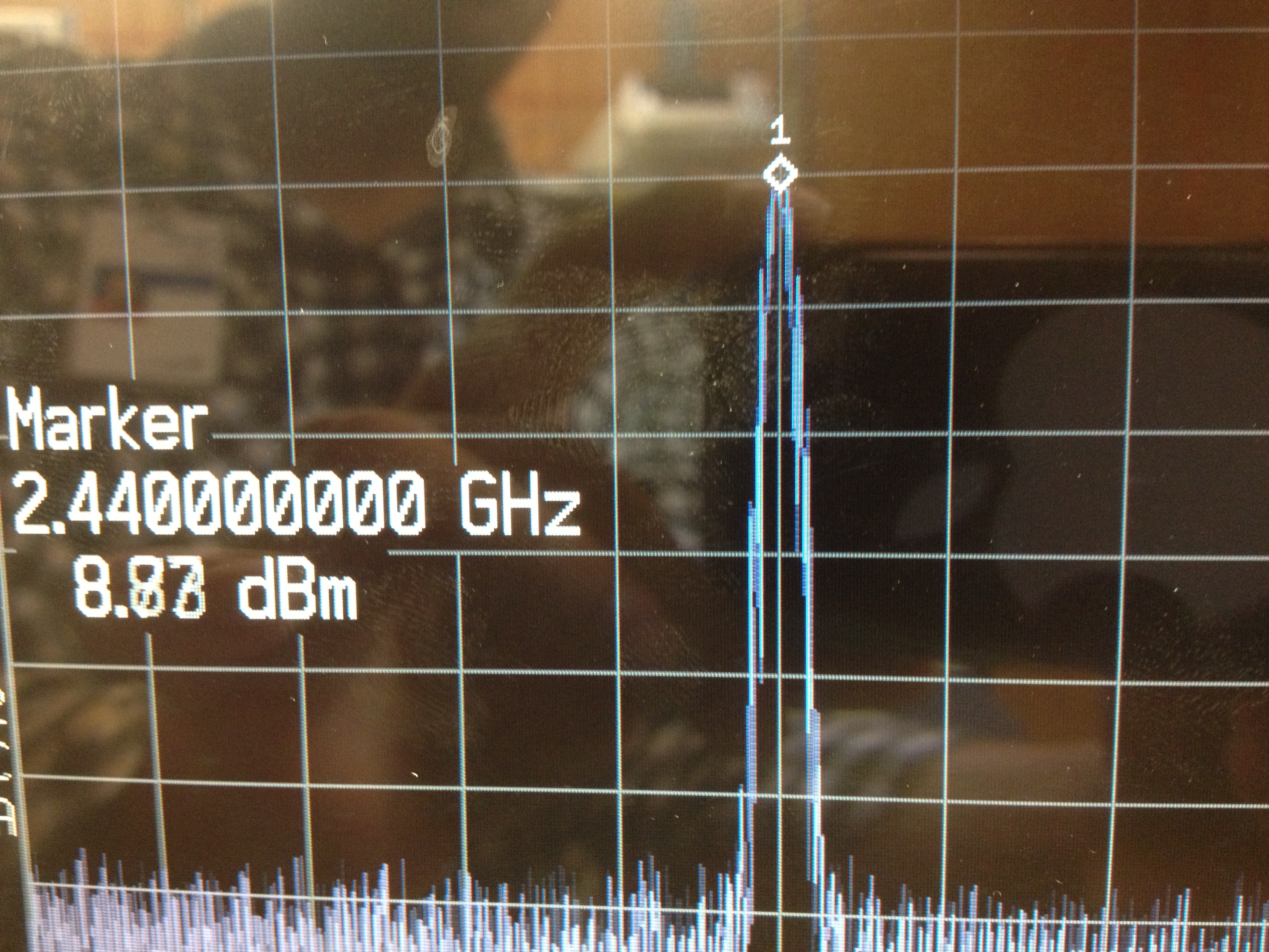

Here is a trace from the BHET: http://processors.wiki.ti.com/index.php/CC256x_Bluetooth_Hardware_Evaluation_Tool
CONTINUOUS TX:
ModulationScheme:0x04(BLE)
TestPattern:0x00(PN9 (Pseudo-Random))
FrequencyChannel:0x26(38 (2440 MHz))
PowerLevel:0x0F
Sent: 0x01, 0x84, 0xFD, 0x0C, 0x04, 0x00, 0x13, 0x0F, 0x00, 0x00, 0x00, 0x00, 0x00, 0x00, 0x00, 0x00,
Returned: 0x04, 0x0E, 0x04, 0x01, 0x84, 0xFD, 0x00,
Sent: 0x01, 0x01, 0xFF, 0x06, 0x0C, 0x18, 0x19, 0x00, 0x01, 0x01,
Returned: 0x04, 0x0E, 0x04, 0x01, 0x01, 0xFF, 0x00,
Sent: 0x01, 0x80, 0xFD, 0x06, 0xFF, 0xFF, 0xFF, 0xFF, 0xFF, 0x01,
Returned: 0x04, 0x0E, 0x04, 0x01, 0x80, 0xFD, 0x00,
And screenshot:
I removed all unnecessary stuff from initializing function but the result is still same. I call just BSC_Initialize-function and change uart baudrate before sending these continuous tx commands. All the other modulations work perfectly, but I can not see anything with BLE_GFSK. HCI output is completly same as in your example.
