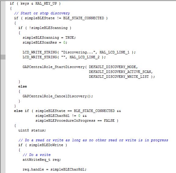

I am modifying SimpeBLECentral and I want to transmit values every 10 seconds after it is connected.
How do I code it to run without the joystick input and delay transmission to 10 seconds?
  • Hello Glendon,
    please add one task event and set one osal_timer
    case GAP_LINK_ESTABLISHED_EVENT:
            if ( pEvent->gap.hdr.status == SUCCESS )
              simpleBLEState = BLE_STATE_CONNECTED;
              simpleBLEConnHandle = pEvent->linkCmpl.connectionHandle;
              simpleBLEProcedureInProgress = TRUE;
              // If service discovery not performed initiate service discovery
              if ( simpleBLECharHdl == 0 )
                osal_start_timerEx( simpleBLETaskId, START_DISCOVERY_EVT, DEFAULT_SVC_DISCOVERY_DELAY );
              LCD_WRITE_STRING( "Connected", HAL_LCD_LINE_1 );
              LCD_WRITE_STRING( bdAddr2Str( pEvent->linkCmpl.devAddr ), HAL_LCD_LINE_2 );
              osal_start_timerEx( simpleBLETaskId, event_name, event_period(10000) ); //set one osal_timer
    and handle your event
    uint16 SimpleBLECentral_ProcessEvent( uint8 task_id, uint16 events )
      VOID task_id; // OSAL required parameter that isn't used in this function
      if ( events & event_name )
        transmit your data here
        // return unprocessed events
        return (events ^ event_name);
