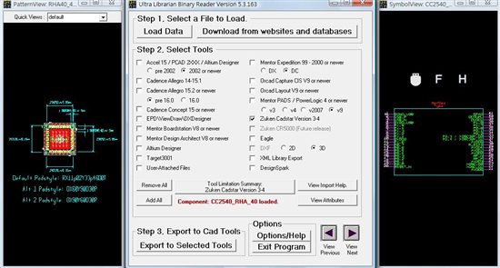

       Would you mention where I can get the design file. I have the MiniDK pcb layout which download from TI website
       I'm using CADSTAR Express V13.
       I have downloaded the ultralibrarian and CC2540_RHA_40.bxl file from TI
      I can generate the xxx.cpa and xxx.csa, but when I use the CADSTAR to import it, it can't import into CARDSTAR
    use the cadstar to import, it will generate the blank untitled.scm file. but it doesn't contain anything.
