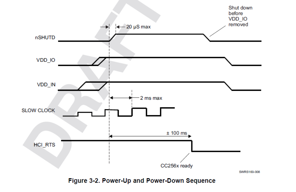

I have a PAN1323ETU module that I am trying to get working. The board is powered at 3.3V, with all logic to the module at the same voltage. (The board has level shifters for the CC256x.) I am supplying a 32.768 kHz slow clock, and I apply voltage to the nSHUT_DOWN pin after the clocks are stable. It takes around 10 seconds for the HCI_RTS line to go low. This sounds like the module is just timing out? It does not respond to any commands sent to it. Anyone have any ideas?

    The RTS line should go low within 100ms of asserting nSHUTD: http://processors.wiki.ti.com/index.php/CC256x_Testing_Guide

    The host processor is MSP430BT5190 in 100-LQFP package.
    The slow clock is generated by a 32768 Hz crystal oscillator, SG3030JC:
      http://www.eea.epson.com/portal/pls/portal/docs/1/1629448.PDF
    This oscillator output is connected directly to the host's P7_0_XIN pin and then becomes ACLK. The on-processor oscillator is bypassed.
    I output ACLK on the P11_0_ACLK pin, which connects to the PAN1326's SLOW_CLK_IN via a level translator.
    I used a 16 MHz oscillator on the board to verify that ACLK is 32768 Hz.
    [Edit: this verification was insufficient to detect that the ACLK frequency was unstable and off by ~1500 ppm. This issue was the cause of the observed PAN1326 behavior. See post below.]
    If I disable the P11_0_ACLK output, the PAN1326 never comes out of reset (shutdown), which is as expected and indicates to me that the ACLK signal makes it to the PAN1326.

    One more question, did you verify that VDD_IO and VDD_IN are present prior to releasing the nShutdown pin?
  • Hi Sundeep,
    Yes. VDD_IO and VDD_IN are always powered up. They are sourced from LDO's on my board. The LDO's are located very close to the PAN1326. The LDO input voltage comes from a battery, ~4V. Each LDO has the recommended 1 uF input and output capacitor. I also tried adding 10uF at each LDO input and output just to be sure there was not an issue with LDO stability. No change in PAN1326 behavior.

  • Hi Steve,
    Are you sure that the Slow Clock frequency is 32.768KHz?
    Miguel
  • Hi Miguel,
    Thank you for asking this question.
    I wrote some code to measure the 32.768 kHz clock vs my 16 MHz clock over a longer period of time.
    Not only was the 32.768 kHz clock frequency off by 1500 ppm, but it would vary from run to run.
    I replaced the oscillator chip with no improvement.
    I hardwired the oscillator output to the SLOW_CLK_IN translator input. The PAN1326 then functioned correctly.
    I then found this post:
    http://e2e.ti.com/support/microcontrollers/msp430/f/166/p/294968/1029242.aspx#1029242
    I added the code from the post:
      while (UCSCTL7 & XT1LFOFFG) {  // convince UCS to use XT1CLK
        UCSCTL7 &= ~XT1LFOFFG;
        SFRIFG1 &= ~OFIFG;
    My code now consistently shows the 32.768 kHz clock to be good to a few ppm.
    I removed the SLOW_CLK_IN hardwire, and now everything is working fine.
    Evidently, the MSP430 was defaulting to an internal clock for ACLK rather than using my external 32.768 kHz clock.
