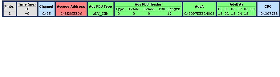

I am using the Smart RF Packet Sniffer to capture the data packets but it only allows to read the UUID and not the values contained in the UUID. I am curious if there is a software tool to read the advertisment data contained in the UUID before the connection is established? Once the connection is established the BTool can be used to read the UUID values. Any comments?

    Thanks for your mail. I have tried both methods earlier and I am still unable to read the advertisement data. The packet sniffer is able to see the UUIDs but not the data. Could you please check at your end if you are able to read the data. I really appreciate it.

    I have checked and verified that Packet Sniffer shows the advertisement data by using the KeyFobDemo project.  You can see in the image that the AdvData corresponds to the advertisement data for the KeyFob.
    If you read the values in reverse order you will see that:
    04 18 = 1804 -> Tx Power
    02 18 = 1802 -> Immediate Alert
    03 18 = 1803 -> Link Loss
    Verify with the KeyFobDemo.  I do not have the CC2541, but the demo code for it should produce the same thing.  In Packet Sniffer in the Select Fields, highlight All the fields.
