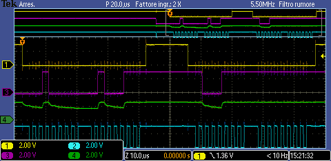

  • Here are some scope data of:
    Write at 0x20 value 0x47 ( first 16bit)
    Rread register 0x0F|0x80 (first bit has to be 1 to read).
    (purple MOSI green MISO)
    Data sent to the accelerometer  seem to be valid but data that are coming back certainly aren't
  • It looks like there are something wrong with the MISO connection between CC2540 and lis3dh. I suggest that you disconnect the MISO of lis3dh from CC2540 and measure the lis3dh MISO first. See if the signal will be correct without connection first.
