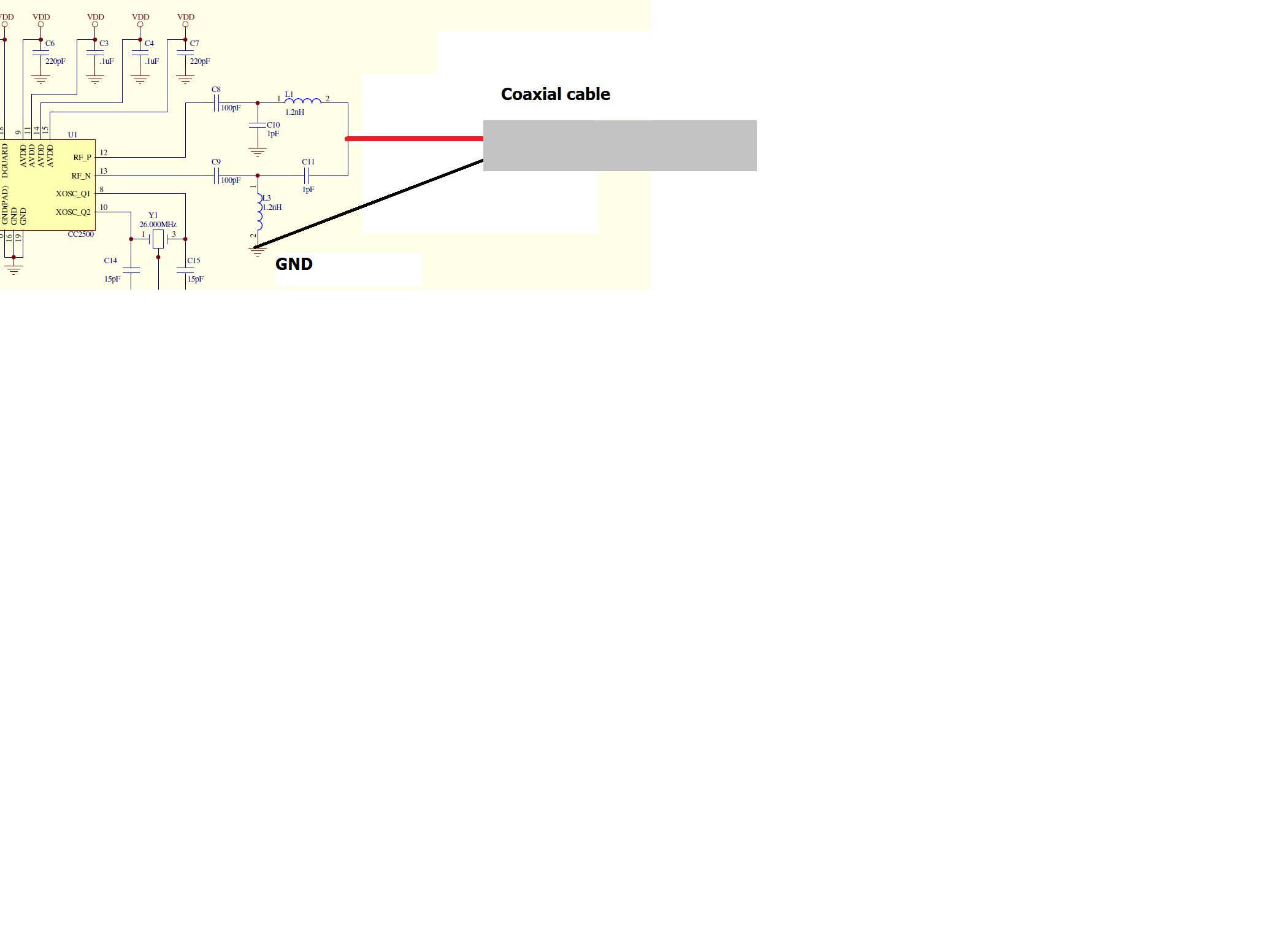

  • Hi, I would like measurement s11 parameter of my wireless system with cc2500. Do I have to connect a coaxial cable with impedance 50ohm instead of the last componenti of the balun? Thanks you Best Regards

  • Hi Fredrik
    I would measurement output power of radio cc 2500 without antenna. For do this, I should remove the PI filter balun, antenna and connect with a coaxial cable between l1 and c11? as Show in the picture?
    Thank you
    Best Regards
  • Ok. You should connect after the PI-filter. By looking at the reference design this seems to be the 50-ohm point.
    Cheers
