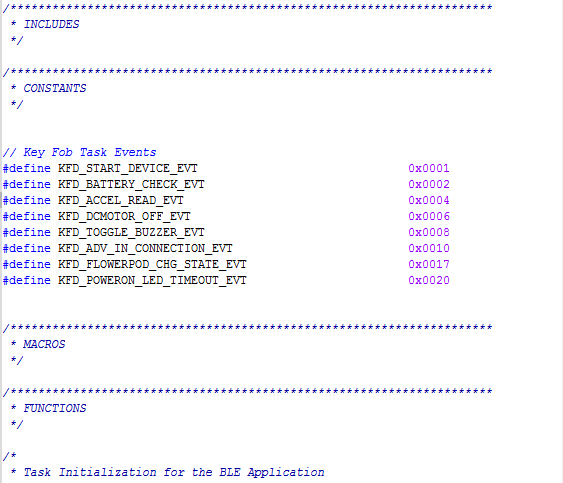

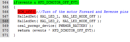

We have a problem with this event showing in the picture below. When we debug and set a breakpoint, we are able to see that the event is trigged but it jumps over the content of the "if" statement. Can this problem be related to the allocation of timer, if so, what is the solution ?

  • Check if your KFD_DCMOTOR_OFF_EVT define is duplicate with others.
  • What is the definition of KFD_DCMOTOR_OFF_EVT?
  • Thanks for the replies. I have uploaded both the c-file and h-file which includes KFD_DCMOTOR_OFF_EVT
    Here is the definition:
    if(events & KFD_DCMOTOR_OFF_EVT)
        DCM_off();//Turn of the motor Forward and Reverse pins
        HalLedSet( HAL_LED_1, HAL_LED_MODE_OFF );
        HalLedSet( HAL_LED_2, HAL_LED_MODE_OFF );
        osal_pwrmgr_device( PWRMGR_BATTERY );
        return (events ^ KFD_DCMOTOR_OFF_EVT);

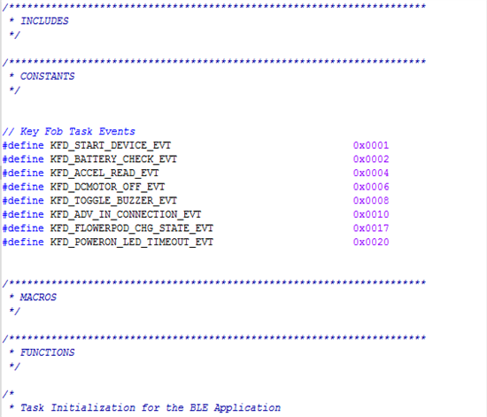

    // Key Fob Task Events
    #define KFD_START_DEVICE_EVT                              0x0001
    #define KFD_BATTERY_CHECK_EVT                             0x0002
    #define KFD_ACCEL_READ_EVT                                0x0004
    #define KFD_DCMOTOR_OFF_EVT                               0x0006
    #define KFD_TOGGLE_BUZZER_EVT                             0x0008
    #define KFD_ADV_IN_CONNECTION_EVT                         0x0010
    #define KFD_FLOWERPOD_CHG_STATE_EVT                       0x0017
    #define KFD_POWERON_LED_TIMEOUT_EVT                       0x0020

  • You can not define KFD_DCMOTOR_OFF_EVT to 0x0006. The event flag is a bit mask of 2 bytes. I can only be 0x0001,0x0002,0x0004,0x0008,0x0010,0x0020,0x0040,0x0080, 0x0100,0x0200,0x0400,0x0800,0x1000,0x2000,0x4000,0x8000. So, you need to change KFD_DCMOTOR_OFF_EVT to 0x0008 and the next four defines to 0x0010,0x0020,0x0040,0x0080.
