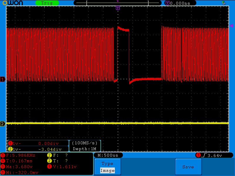

Doing project on CC2541 using BLE. So I use OSAL and other pre-made goodies from TI. I now try to generate IR signals on P1_0 using Timer 0 channel 2 and never got it working properly. Including many other problems I observe output with ghost delays like shown on this oscillogram:
This all makes me think that BLE stack or OSAL is trying to use Timer 1 too. Meanwhile I found no information what timers are used by OSAL and what are pitfalls. Relevant code is included. I run Timer 1 from system clock divided by 8. T1CC0 is 100. This all should give 25kHz clock I think. I actually get 38kHz and very weird but cycle length is "floating" on oscilloscope screen.

  • Timer 1, 3 and 4 are free to use.
    But be default the system clocks are stopped during Rf radio use!
    You have to put these in the initialization ( like in void SimpleBLEPeripheral_Init( uint8 task_id ) ) to stop that:
    LL_EXT_HaltDuringRf(LL_EXT_HALT_DURING_RF_DISABLE) ; // turn off RF CPU halt
    HCI_EXT_ClkDivOnHaltCmd( HCI_EXT_DISABLE_CLK_DIVIDE_ON_HALT );
    That probably fixes your problem.
    BUT if your trying to handle interrupts, OSAL TURNS OFF interrupts for up to something like 125us, and I haven't worked out how to get around that in a real-time system.
    This means you get lost/ delayed interrupts when trying to use the low level timers for timing! If you can stick with OSAL events and can cope with the jitter of 1ms or more, you will be better off.
  • You're a life-saver, Adrian.
    I have been searching three days for a solution for my problem with irregular tones generated by timer 1. The line:
    solved it.
    Big thanks!
