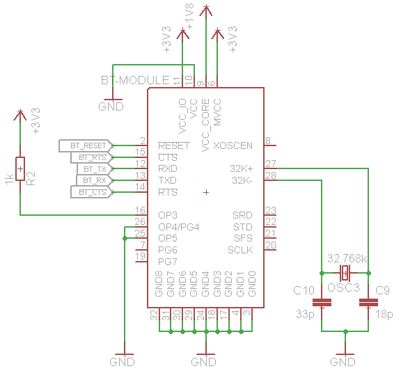

after several (perfectly working) LMX9838 designs, I encountered a serious problem.
We assembled a few new prototypes: some are working, most are not.
Tomorrow I will check if they are from the same batch, but anyway has somebody encountered a similar issue?
The external clock is working, but the TX line will stay low and the module is not discoverable over bluetooth. Also the start-up message is missing.
All use the same wiring. Since the systems have got dual supply (3.3V and 1.8V) we implemented this according to the datasheet.
Thanks in advance for any hints!

  • I am having EXACTLY the same problem. I did a design with the LMX9838 about 2 years ago. It worked perfectly. I designed a new board exactly the same way and none of them came up. I've spend the better part of two weeks and purchased more of the devices from digikey until I began to suspect the device. At that point, I soldered down a couple of parts on the old boards (which previously worked) and the new devices aren't working. They are not discoverable. They don't do anything. I verified the reset line is being cycled and I verified proper voltage at the 3.3 pins and verified that the 1.8 core voltage was up. In fact, it is about 1.75V. Frustrated!

  • I got the same problem? It is almost as if the chip doesn't start-up correctly.. Please let me know of possible solutions. I have done a first prototype that worked great. So this is really not making sense..
  • Make certain the pull-ups on OP3, OP4 and OP5 are 1K.
    I had increased those values to reduce power consumption and as a result, the part comes up at the wrong baud rate.
    Verify core voltages.
    Although easy to work with, this part is a bit dated - especially for power consumption.
    It used to be my go-to part, but for battery powered operation, it leaves much to be desired.
    Sam Michael
