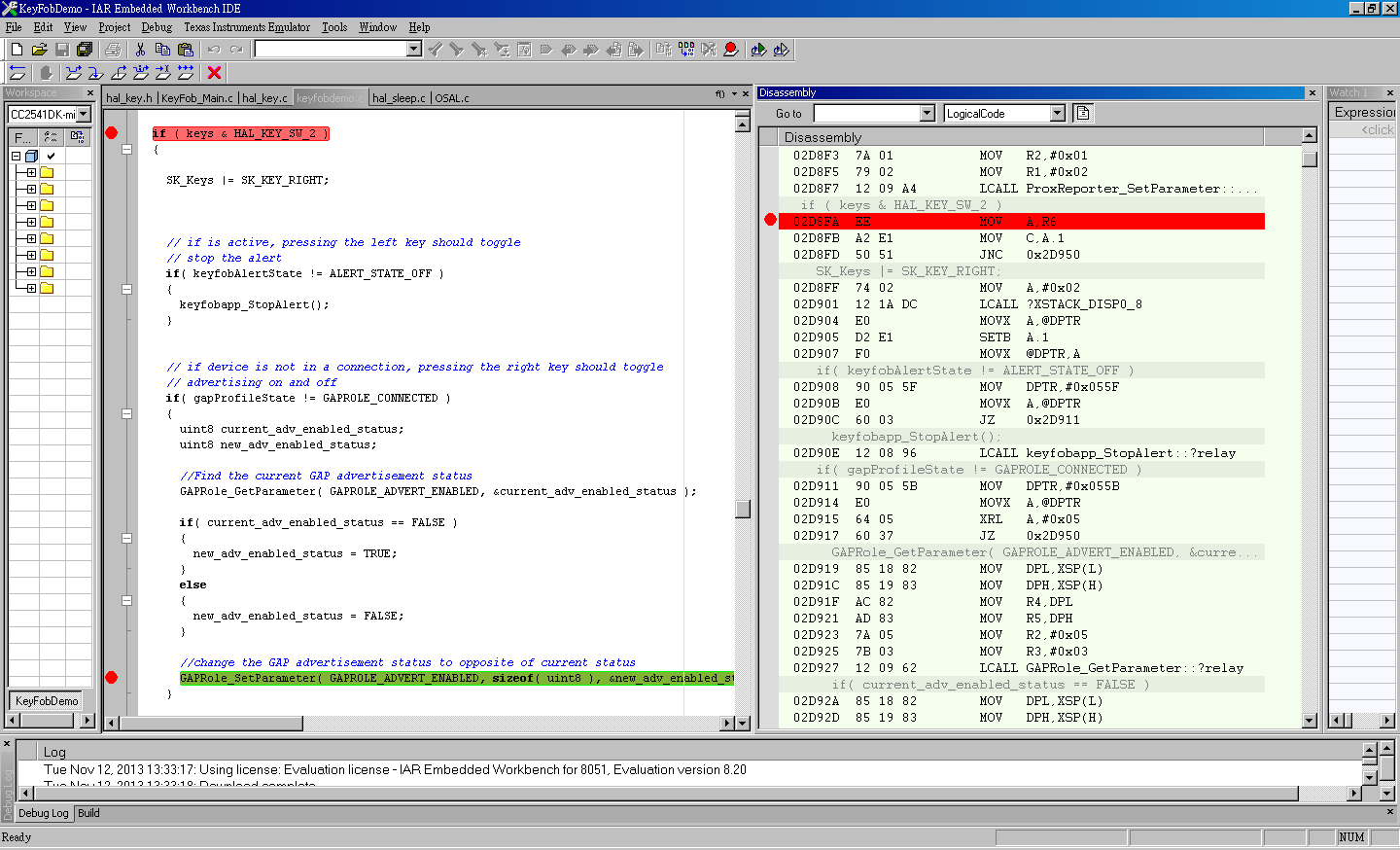

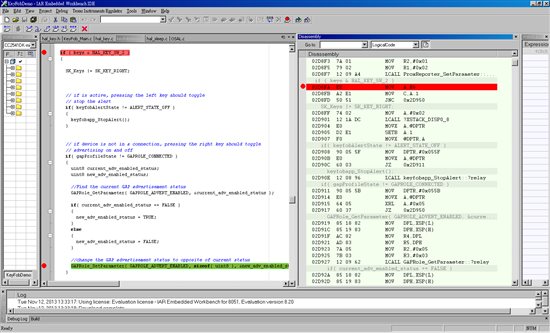

    I set the breakpoint at if ( keys & HAL_KEY_SW_2 ), and it call this function after 10 seconds when power on.
    And the information at breakpoint like the picture.

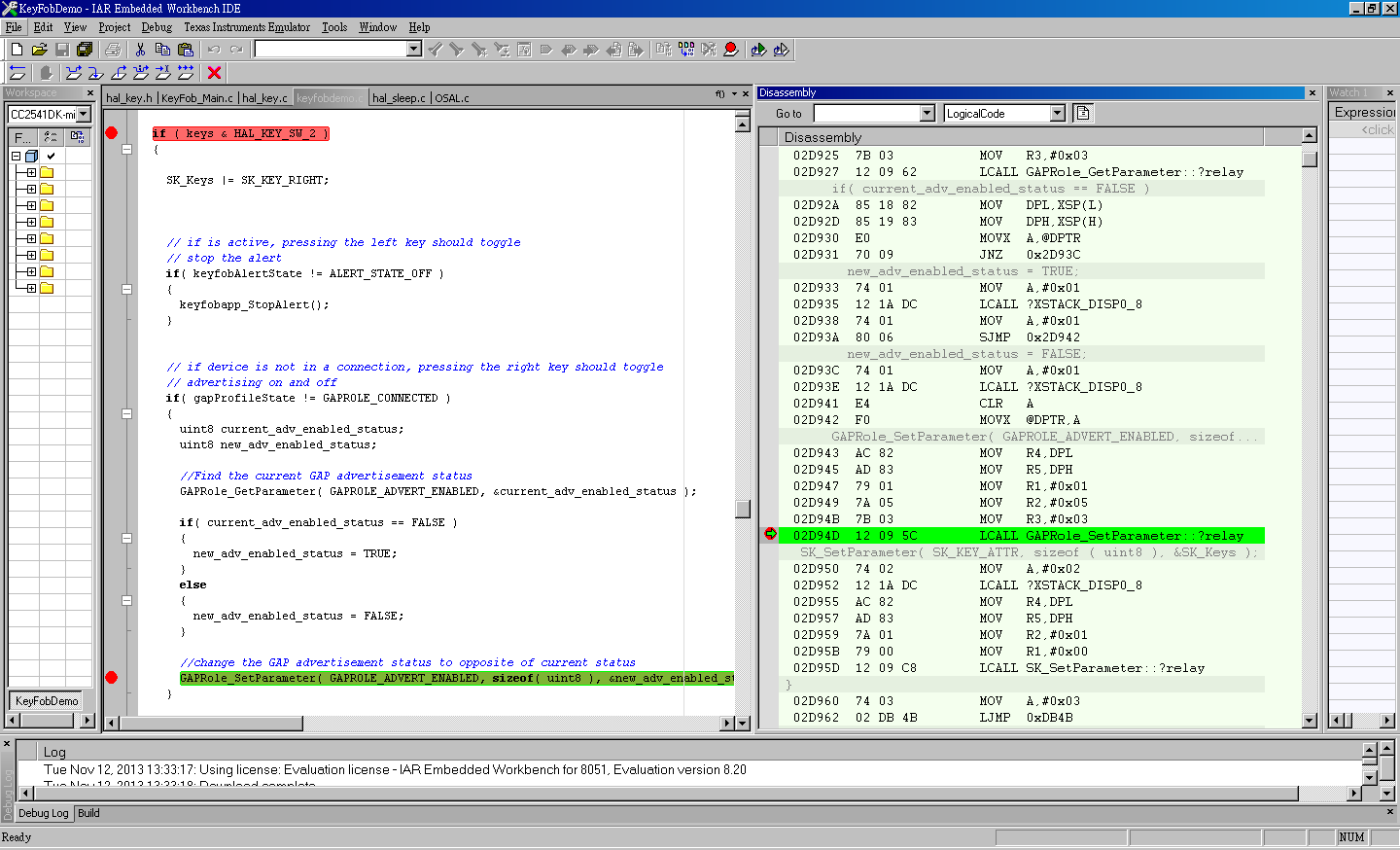

    Set the breakpoints at  if( current_adv_enabled_status == FALSE ) , and the picture is like the following:
    I am new to this ,so I didn't know what it mean...
    and the button at Pin P1_5 still without any operation , and it will be trigger after 10 seconds when power on.
