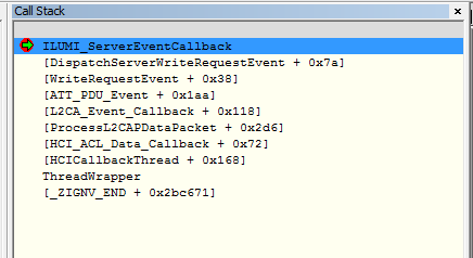

    Since we are trying to track down why GATT Server event call back is not triggered,
    is there any way we can debug to check which layer of the following call stack causes the problem?
    Difference between 5335 and 5190BT (5383A).
    5335 code memory space starts 0x8000
    5190BT code memory space starts 0x5c00
    So when rebuilding the code for 5335, the project uses more 20bit address space than 5190BT, does this ring any bell?

    So my guess is that along the protocol stack from HCI to GATT Server, there is a related counter.
    And when porting to 20-bit code memory, its related constant or function not perform
    as expected any more.
    Does my logic sound reasonable?

    GET_NEXT_ALARM_TIME RSP 244
    bytes_send = 0x8
    RSP_DelayWrite 245
    RSP_DelayWrite 246
    SET_COLOR_PATTERN ssize = cSave scene data FF 00 00 00 FF 00 2C 01 00 00 00 00 00 FF 00 00 FF 00 2C 01 00 00 00 00
    RSP exe write 247
    SET_DAILY_ALARM Save alarm data 02 04 04 B2 02 11 44 48 03 3E 01 00 FC 2D
    RSP 248
    GET_NEXT_ALARM_TIME RSP 249  <------------------Dead
    bytes_send = 0x8
