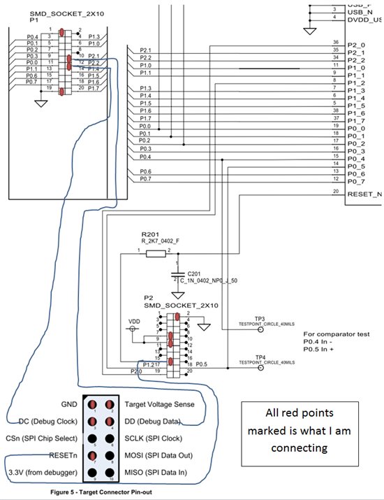

Hi, I have tried several times without lucky so I need to ask to experienced guys.
I have the CC2540EMK and the CC Debugger, I like to flash the CC2540 and always have the red light in the Debugger.
My questions are:
1. In the CC2540EMK includes 2 board, Master and Peripherial, what is the difference between them?
2. I am attaching an image with my connections, probably I am missing something, please let me know if it is correct or not? And if so, what will be the physical points that I need to check in the CC2540EM to see if it is working properly?
I am supplying 3.3v for both (CC2540EM and CC Debugger)
Please help me because I do not know what else I need to do
  • Hi Osvaldo,
    1) I believe there is no difference between the two CC2540EMs included in the CC2540EMKit.
    2) a) How do you supply voltage to the CC2540EM? An option is to use CC Debugger to power the target
    b) Target Voltage Sense should be connected to the target's VDD. This signal is used by the CC Debugger's level shifters and nothing will work without it being connected to something.
    Have you considered the System-on-Chip battery board? (SOC-BB). It is made for use with EMs like CC2540 + CC Debugger and may make your life easier.
    Br,
    TIABO

    I also highly recommend ordering the SoC Batteryboard. Without seeing your setup I guess the red_LED issue is due to a wrong or missing connection.
