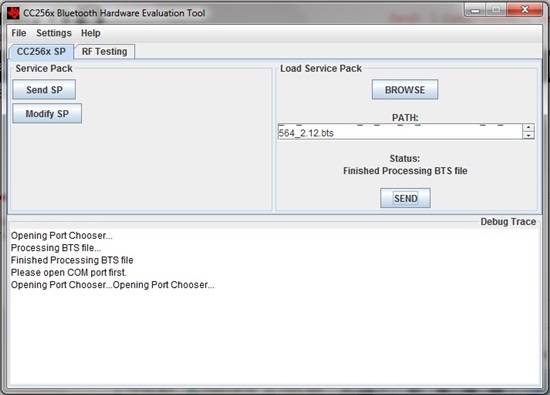

Hi All,
I tried to load SP to pan1323 but can connect to COM port because port chooser wont open.
David.

    I downloaded java form http://www.oracle.com/technetwork/java/javase/downloads/index.html , JDK and JRE and installed.
    From wiki section Setting Java Path:
    Change line 4 to:
    start "C:\Program Files (x86)\Java\jre7\bin\javaw -jar" BT_TOOL_EXE.jar
    and
    included C:\Program Files (x86)\Java\jre7\bin to PATH variable.
    Still the same thing happens.

    I attached the log from cmd when I clicked the "Settings->Select Port"
    On screen -> "Opening Port Chooser..."

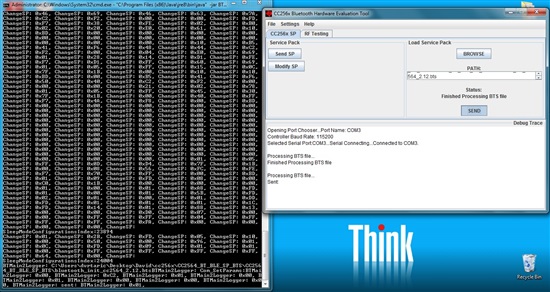

    One more thing
    After i choose the service pack and click send it says:
    "Sent:"
    Means that the SP is updated or it crashed?
    Regards.
  • Hi ZeroD,
    I'm not sure if this is what you expect to see... Usually you should see the command, and the response in the "Debug Trace" window.
    Gigi Joseph.
  • Hi Joseph,
    I waited for 30 min, and nothing happened then I unplug the USB module by force and then on the window of the BHET printed out this: see "BHET log.txt"
    Opening Port Chooser...Port Name: COM3
    Controller Baud Rate: 115200
    Selected Serial Port:COM3...Serial Connecting...Connected to COM3.
    Processing BTS file...
    Finished Processing BTS file
    Header file saved in: C:\Users\dvrtaric\Desktop\David\cc256x\CC2564_BT_BLE_SP_BTS\sp.h
    Sent: 0x01, Sent: Sent: Sent: Sent: Sent: Sent: Sent: Sent: Sent: Sent: Sent: Sent: Sent: Sent: Sent: Sent: Sent: Sent: Sent: Sent: Sent: Sent: Sent: Sent: Sent: Sent: Sent: Sent: Sent: Sent: Sent: Sent: Sent: Sent: Sent: Sent: Sent: Sent: Sent: Sent: Sent: Sent: Sent: Sent: Sent: Sent: Sent: Sent: Sent: Sent: Sent: Sent: Sent: Sent: Sent: Sent: Sent: Sent: Sent: Sent: Sent: Sent: Sent: Sent: Sent: Sent: Sent: Sent: Sent: Sent: Sent: Sent: Sent: Sent: Sent: Sent: Sent: Sent: Sent: Sent: Sent: Sent: Sent: Sent: Sent: Sent: Sent: Sent: Sent: Sent: Sent: Sent: Sent: Sent: Sent: Sent: Sent: Sent: Sent: Sent: Sent: Sent: Sent: Sent: Sent: Sent: Sent: Sent: Sent: Sent: Sent: Sent: Sent: Sent: Sent: Sent: Sent: Sent: Sent: Sent: Sent: Sent: Sent: Sent: Sent: Sent: Sent: Sent: Sent: Sent: Sent: Sent: Sent: Sent: Sent: Sent: Sent: Sent: Sent: Sent: Sent: Sent: Sent: Finished Processing BTS file
    I don't know if this is ok.
    How to check on the module what SP is he using?
    How to add SP to may code via IAR?
    Regards.
