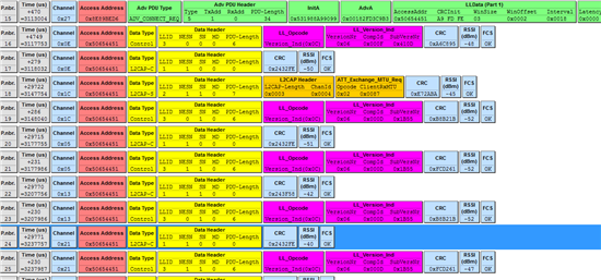

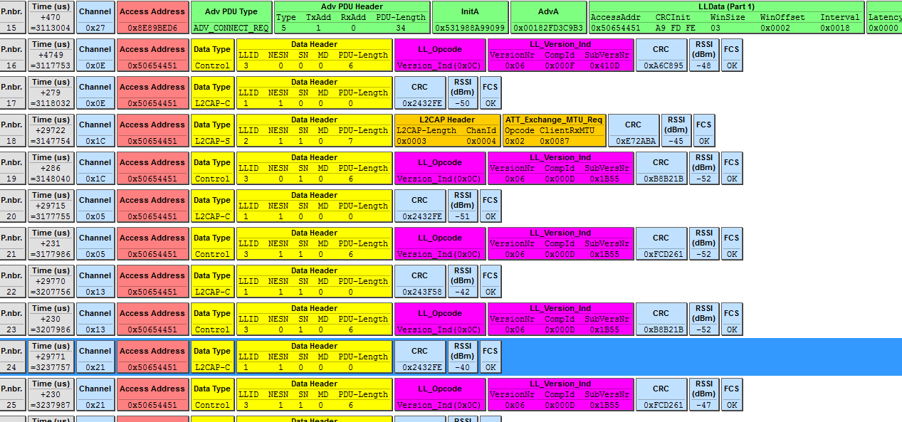

On iOS7 side, after repeatedly connection and disconnection with BLE peripheral
after 3~ 7 minutes, iOS7 would fail to discover GATT service after making a connection.
Packet sniffers shows that iOS7 is doing some weird thing after connection,
it keeps sending LL_Version packet instead of discover ATT attributes.
