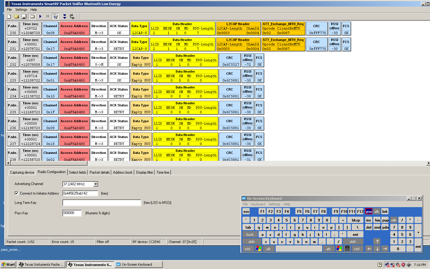

  • Ah... I was just able to capture a failure condition here when there were other devices in the same room.
    See attached screenshots from the sniffer.  Also, the PSD file is attached.
    A connect seems to form, but then we just get lots of Empty PDU packets and then eventually the connection disconnects.
    Thanks!
    Brian

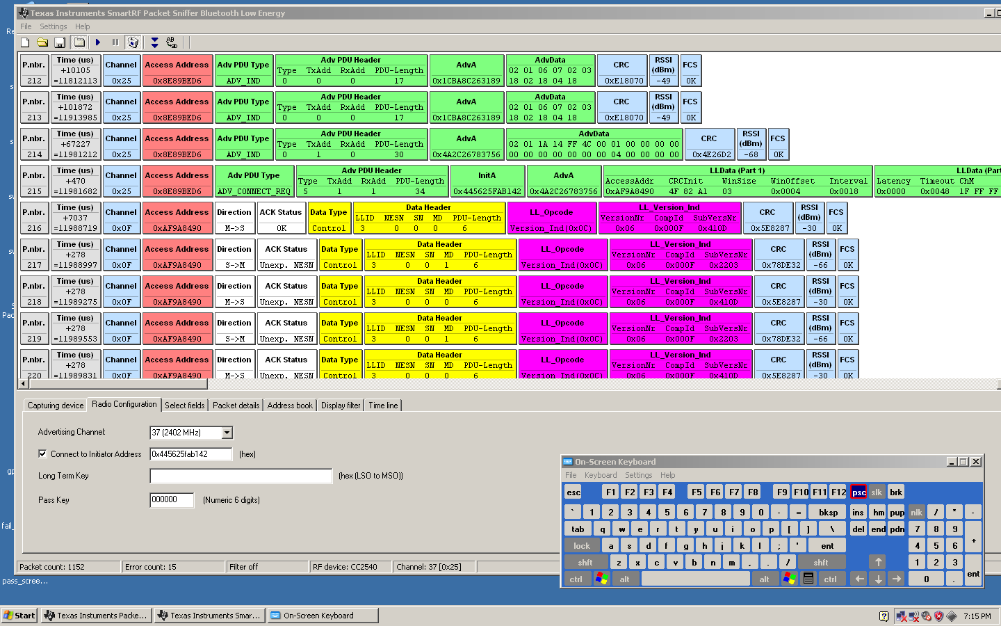

  • Here's also a working trace in comparison.
    6036.working0129.psd
  • Hi Brian,
    Your sniff capture shows that the connection is made, but during the connection there seem to be many retries and not much data.

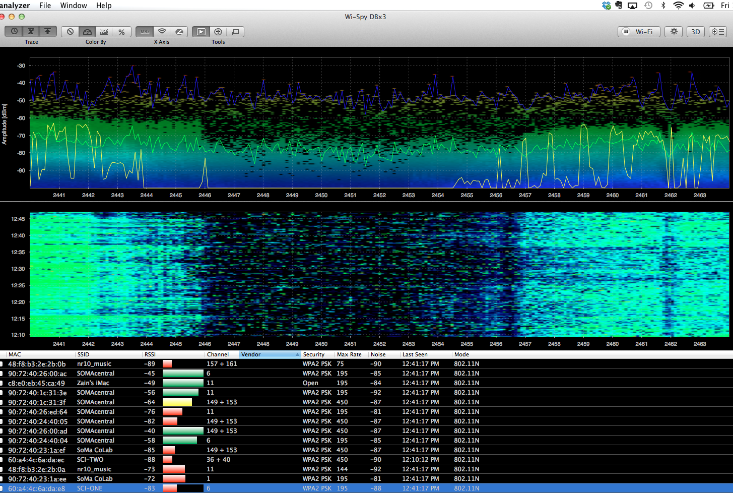

  • I don't know that anything can be done in software about Wifi interference.  My impression is that Bluetooth interferes with Wifi more than the other way around.
    Antenna design must play a role, but that's way outside my expertise.
  • one of the videos in this page http://focus.ti.com/docs/training/catalog/events/event.jhtml?sku=OLT313004
    shows a picture of the 40 channels, 3 adv channel and 37 data channel, the 3 adv channles are selected to be with less interference from wifi, but the 37 data channel might have severe interference from wifi.
    in the case posted with many strong wifi signals of laptos, severe interference might  block all the data channels, so that connection events, which are carried in the data channels, will be suppressed by wifi signals, and connection not easy to setup and easy to lost.

  • Hey guys,
    Thanks for all the responses on this.  Wow.  I think we might just be up against a wall here in terms of interference.   Here's a quick screenshot we took using MetaGeek's Channelyzer.   With this Wifi background our sensor is still working fine.  I'll post a screenshot of when it's not working shortly, but I'll bet it's a lot more crowded.
    Are there any things we could do in terms of the connection parameters that might make the connection more robust in a crowded space?  Also, would adding a CC2590 front end help, by essentially making our signal stronger the WiFi around us?   Other ideas?    We're going to be up on stage in front of a very large audience shortly, full of people on laptops… and trying to figure out how to make the demo rock the house.
