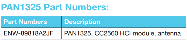

    Says that PAN1325A and PAN1315A are based on CC2560. Is that the reason my code is not working? The datasheets I have does not say about this difference. I am confused about this. Can you help me out?
    warm regards,
    Sharadanand
  • Hi Sharasanand,
    Initially you started the thread that you are using PAN 1327, which I said is no longer supported.
    Then You said you are using PAN1325. If so, it contains CC2560 even from the link you have shared see below.
