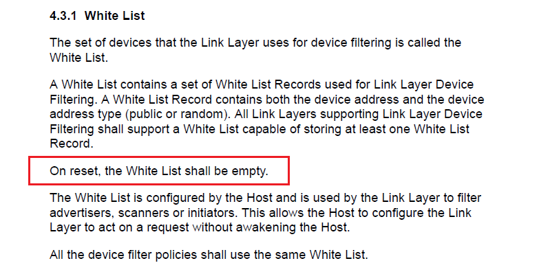

I'm using the PAN1323 module with the Bluetopia stack. My question is whether or not the white list is preserved by the CC256x device. Or, does the white list need to be re-established after every power cycle?
Thank you,
Brent

Thank you, Sundeep!
So it sounds like if I need it preserved, I'll need to save it to flash and reload the list myself in the event of a power cycle.
Thanks again,
Brent
