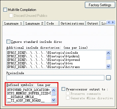

  • Hi Sundeep,
    I am using v1.4R1 sdk, and having a one question.
    I set up this board in "Release - A3DP SNK Board" mode, deleting the flag "__TI_A3DP_SNK_BOARD__", and then I let iphone connect the device as these steps(http://processors.wiki.ti.com/index.php/CC256x_MSP430_Bluetopia_Basic_AssistedA2DPSinkDemo_APP).
    And the problem is no music output !

  • I have already found the solution.
    In MainThread function, I enable the fuction "HAL_ConfigureCodec()", then the problem is solved.

  • Hi Ravi,
    For first problem:
    To delete the "__TI_A3DP_SNK_BOARD__" in the red rectangular,
    For second problem:
    U can modify code as follows in "MainThread" function in "Main.c".
    Before:
    BluetoothStackID = (unsigned int)Result;
    #ifdef __TI_A3DP_SNK_BOARD__
    HAL_ConfigureCodec();
    #endif
    After:
    //shawn modify for SNK BOARD
    //#ifdef __TI_A3DP_SNK_BOARD__
    //#endif

    there are some configurations you should recheck:
    1. workspace: Release - A3DP SNK Board;
    2. deleting "__TI_A3DP_SNK_BOARD__" for the other mode, and then you can see "opensink" cmd;
    3. enable  the function "HAL_ConfigureCodec".
    That's all my modfications, and I suspect that you have some hardware problems.
