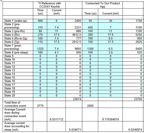

I am attaching the power consumption comparison chart for Keyfob and our device in connected state.
              Image 1:  power consumption comparison chart for Keyfob and our device in connected state

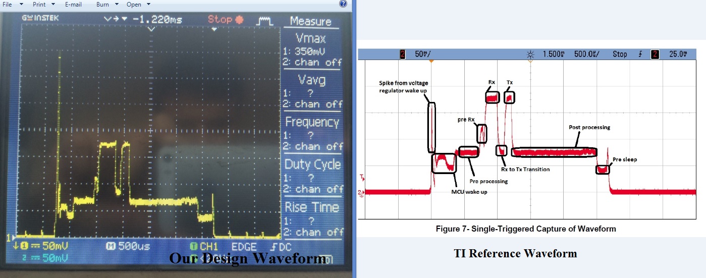

I am also attaching the waveforms obtained  while testing  for our device along with the  TI's reference waveform.
Connected State
              Image 2: Wave forms obtained in Connected State for our Device 'vs' Keyfob reference design
The obtained wave form looks similar to the TI's reference wave form if it was in connected state with our App.

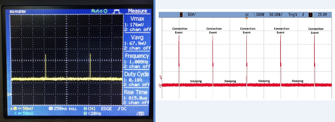

Advertising State
In advertising State, its different from the Reference design, it consumes nearly 8mAh power while advertising and consumes even more during connection event.
            Image 3: Wave forms obtained in Advertising State for our Device 'vs' Keyfob reference design

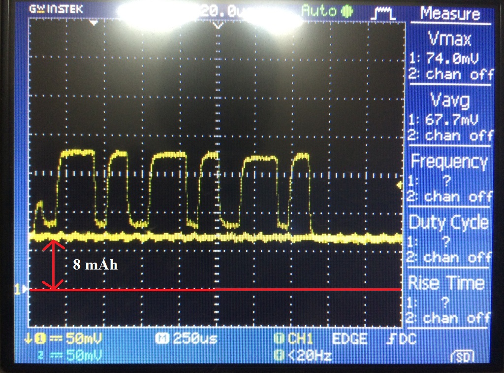

                 Image 4: Wave form  showing default power consumption in Advertising State for our Device
This image clearly shows that by default it consumes 8mAh during advertising and consumes even more power during connection intervals. Hence, our device consumes more power in advertising mode that reduces the battery life.

    The 8mA is most likely a result of you not going to sleep PM2, I would check that you have POWER_SAVING and are entering osal_pwrmgr_powerconserve. Note, that having debugger hooked up will keep CPU awake, so you will get higher current readings, but it will still go through sleep code states.

    One of Krishna's colleague here. We have confirmed that Power saving feature is enabled- we are able to enter PM2 mode once connected to the iOS app -- that is why we are able to match TI's average current calculations. Just not able to enter sleep while advertising for some reason. We do not have any pending events that might prevent the processor from sleeping between advertising events. Also, I can confirm that the DUT is not connected to the debugger.

    We had a timer and another event running-- which was preventing the processor from going into sleep. The processor will sleep only if no events and timers are pending!
