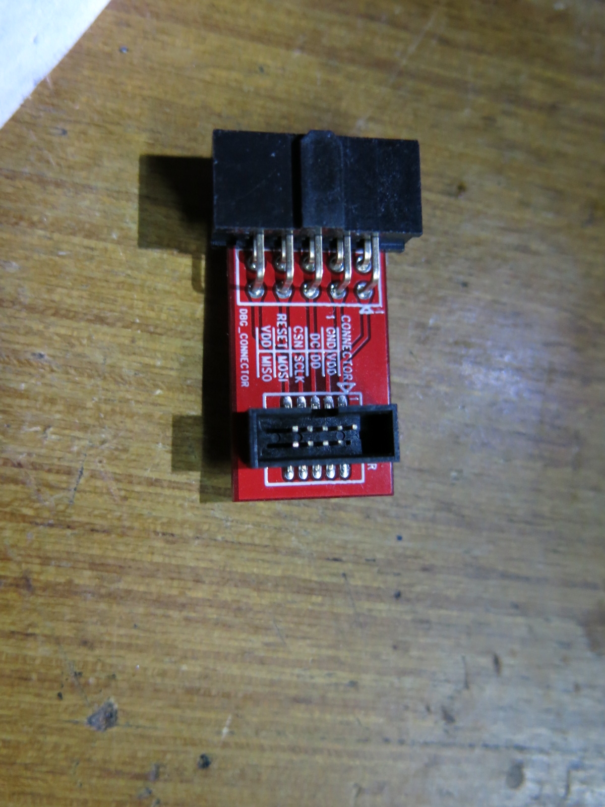

    While checking continuity i found that pin 2 on small adapter board is missing, please see below picture.
    for all other pins i got continuity from dongle pins to mini adapter board pins.

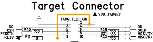

    Pin 2 is the "target voltage detect" pin for the CC Debugger level shifters. Without it it will not detect a target.
    You can work around this by shorting pin 2 (VDD_TARGET) with pin 9 (+3.3V) on the CC Debugger. This tricks the level shifters into believing the target runs at 3.3 V.
    This of course has a limitation: With this workaround, you must power the target at 3.3 V (+/- 0.3 V)!
    The safest is to power the target using the CC Debugger.

    1:
    Pin 9 on the debug connector ("sense") is used to level shift signals to/from the CC2541 interfacing CC debugger.
    If you have tied it to the supply of the debugger at 3.3V the level shifters might have issues detecting a 2.1V input as a valid digital "1".
    Ideally the output of the DC/DC should probably be connected to pin 2.
