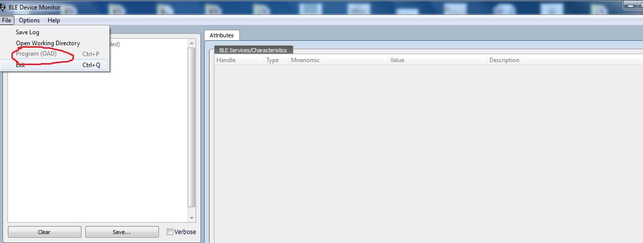

As far as i know that if we like to upgrade the formware of BLE Device Monitor we can use OAD feature .
 After select the file tab of BLE device Monitor , i found that  Program (OAD) is disable . is there any other alternative solution to upload OAD?
thanks in advance
Best regards
 intissar
    You will need the following.
    - Dev Monitor hooked up to CC254X running HostTestRelease communicating with USA or UART
    - Target Device with OAD profile support (sensor tag had this by default)
    - A connection between the two devices.
    Dev monotor will communicated with device and look for the UUID supporting OAD. OAD is a TI developed architecture.
    BR,
    -Greg

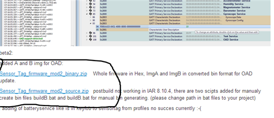

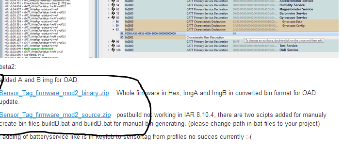

    Thank you very much for your reply. however, it's my first time using SensorTag.
    i have a SensorTag, BLE dongle 2541 and  application BLE Device Monitor like application. in fact, i like to use OAD to let working Application c# of Helath demo , i don't know how upload A and B image for OAD.I try to do this with BLE device Monitor but it doesn't work.
    This is the site of application health demo http://www.orcs.sebsoft.com/index.php/79-vision/72-how-to-acquire-data-by-c-from-bluetooth-4-bluetooth-low-energy-ti-ble-keyfob-ti-sensor-tag .i tried to to modify just the firmware of Sensortag and it works well but i have some functions does'nt work , For this reason, i like to try wwith OAD.
    PS: please, can we tell me what is the difference in this site between Firmware mod of SensorTag and OAD?
    Thanks in advance
