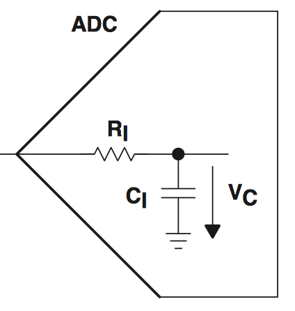

Can anybody help me the minimum adc aquisition time for CC2540/CC2541 BLE SOC? Also, what is the input sampling capacitance of the adc SAR input?

The real issue is that the "characteristic resistance" of 176kohms, while probably accurate for the conditions under which it was determined, is not very meaningful in terms of designing new ADC applications. The actual criteria that are required are the input RC sample-and-hold network values (RI and CI) below, as well as the percentage of the sample period that the switch is allowed to charge. The sample frequency is 4MHz so the sampling time should be well under 250ns.
An actual answer to the question posed by Joemir and myself are three parameters: RI, CI, Ts. The answers provided in this thread and elsewhere don't contain any of that information.
To attempt to partially answer this question based on the 176kohm characteristic resistance with a low-impedance 3V input, we can assume that the sampling capacitor is exposed to the 3V input voltage long enough to fully charge, and that it discharges completely every 250ns sample period.
If the apparent resistance into the pin is 176k at 3V, that means the average current into the pin over the 250ns sample period is about 17uA. Using the basic definition of a farad (F = A * s / V), we can calculate the capacitance of the sample-and-hold capacitor as C = 17uA * 250ns / 3V = 1.4pF. This is the same result as in the other thread, but the origin of the formula used there, 176kohm = 1 / (C * 4MHz), was not obvious or explained.
Assuming that the sampling capacitor is 1.4pF, we still do not know how quickly that capacitor can charge (governed by RI) or how much time the ADC allows the capacitor to charge (governed by Ts). Those two parameters are just as critical for ADC input design but the 176kohm/3V spec does not give any indication of their value.

You are correct in stating that the input impedance (Reactance X_c) of a capacitor is defined by 1 / (2pi * f * C), but for a switched capacitor circuit the equivalent input resistance which is based on the average current flowing into the ADC input which is given by 1 / (f * C) ( can be seen in the picture below ).
The charging current of a capacitor asymptotically approaches zero as the capacitor becomes charged up to the connected source voltage. This means you are correct in stating that the input impedance is not constant during charge, but we are using the average to define the equivalent resistance here.

- "The formula for the impedance of a capacitor is 1 / (2pi * f * C), NOT 1 / (f * C)": This is wrong. See chapter 12.4 in "Design of Analog CMOS Integrated Circuits" (Razavi) or chapter 5 in "Analog MOS integrated circuits for signal processing" (Gregorian/ Temes). The equivalent resistance at the input of a SC integrator is 1/(f*C).
- The equivalent resistor model could be used to calculate how to drive the ADC input for a given ENOB, see the attached document (part of a not released app note) on how this could be used to calculate the component values for a resistor ladder. 5810.SOC_ADC.docx

The details of the ADC input stage do not match the earlier figure in three respects, one is that the initial charge on the sampling capacitor is not necessarily zero, second is that the ADC is differential and third the input is sampled in two different ways during one clock period. I will not go into the actual details here, but unfortunately a simple AC model would probably not be a good starting point as non-linarites and the changed impedance during the clock period would be difficult to capture. Rather the given impedance is to give the user an idea of required source impedance/how much current the source must be able to deliver.
We can model this by an ideal voltage source with serial output impedance called R0. The output of R0 is then hooked up with one of the IFADC inputs which have an equivalent input resistance Rin (176k). If the voltage of the ideal voltage source is Vin, the voltage after R0 would be V0, which is ideally the input voltage seen by the ADC.
Using ohm-law and an assumption that the acceptable voltage error is much smaller than 1, make certain that R0 < Rin*e, where e is the acceptable relative error.
E.g. if you accept 1/1000 voltage droop from the ideal voltage to the ADC input (10 bits would be 1/1024), e=1/1000, Rin=176k so R0 < 176 ohm. I would advise to keep a good margin here if accuracy is important as there are also some internal switches which adds non-linearity and some resistance to the equation.
If you don't have an ideal voltage source you need to define one which is good enough. One way is to create a voltage divider where the resistor in parallel with the ADC is significantly smaller than the ADC input. I would not recommend to only adding a single series resistance to the ADC though as the ADC impedance also has significant process variation. Hence even if you find a solution that works well with a particular device you should expect very large process variation and a resulting large performance spread.
