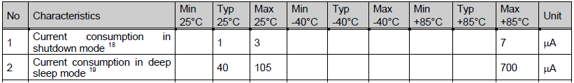

  • Sundeep Mandava said:
    For this you have to disable the discoverable mode of the chip. Sleep does not mean that the chip is turned off.
    ok, maybe i asked the wrong question..
    i would like to turn it off!
    see the attachment, i would like to reach the 1uA, not the 40uA...
    this is why i asked for the shutdown-line...
  • Hi Daniel,
    You need to toggle the GPIO to see the Current consumption in shutdown mode.
  • ok, but i think this GPIO is also used for reset/boot/initialisition of the PAN on other positions in the code!?
    i do not want to disturb any of the existing parts..
    this was my original question, on which position of the SPPDemo do you recommend to switch off the PAN?
    is there any initialisation necessary after the PAN comes back from shutdown?
    or is there no problem at all? can i just switch off and on the PAN in my application without regarding anything else?
  • Hi Daniel,
    If you want to test the current consumption in shutdown mode, you need to toggle the GPIO(down).
    Yes the PAN will be switched off if you toggle the GPIO(down). and Yes you need to download the service pack once again after coming back from shutdown.
