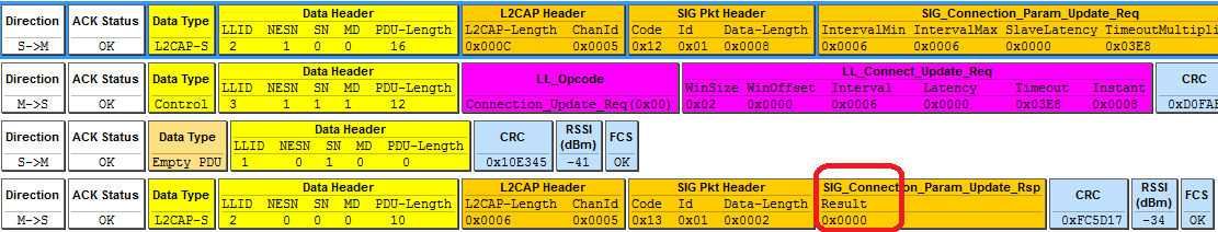

Dear Sir,
            I am trying to connect WL1835MOD Bluetooth Low Energy(Bluetopia stack on Linux) with CC2540(we call the instrument LBT). The connection is created succesfully but it lasts less that 1 sec.
I connect the WL1835MOD BLE with BLED112 dongle(from Bluegiga, built around CC2540) with no problem.
 If I try  Dongle-LBT connection, there is no problem too.3286.ProblemConnect.rar
Following you can see the command and responses of the first scenario process and attached are the FTS logs of WL1835+ bluetopia enabled stack debugging
    GATM>ConnectWithRemoteDevice 1CBA8C1B7635 1

  • Hi Beatriz,
    From the logs what I can see is that.
    1. WL18xx has initiated a LE connection and is been accepted by CC2540.
    2. After connection complete the CC2540 device, sends the L2CAP_Connection_Parameter_Update command to update the connection parameters with the parameters: Connection interval Min = 7.5, connection interval Max=7.5, Connection supervision timeout =10000.
    3. But it is rejected by the Bluetopia stack(WL18xx), as the min/max connection interval as set to 10 and 20 respectively by the Bluetopia stack device (and the spec allows the master to reject the connection_parameter_update from slave).
    4. After this, I think the connection is dropped because of LSTO.
    I have try to test the same scenario on my side with the same connection parametes, unfortunately the CC2540 does not send any update parameter request, so my connection does not disconnect (same as with Dongle).
    I think you can try changing the Connection interval Min value to >= 10 and Connection interval Max value to >= 20 on CC2540 and try the same scenario.
    Alternatively, you can try to use the “Bluetopia” binaries (example on how to run: ./LinuxSPPLE 1 1 3000000, located at BluetopiaPM\Bluetopia\bin) where there is no restriction on connection interval min/max.

    You can provide me the air sniffer logs for both cases mentioned above. But It looks like the problem is in CC2540(The image you are using on that).

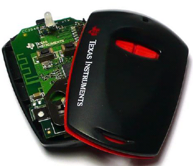

  • Dear Sundeep,
                 have attached the image of CC2540. In the meantime I am preparing the air sniffer.
    Best Regards.
    Francisco.
    8203.BLE.zip
  • Dear Sundeep,
                          have attached the air sniffer that I caught under both scenarios.
    Best regards.
    Francisco.5773.Airsniffer_Wl1835_BLE112Dongle.psd
    4061.Airsniffer_Wl1835_CC2540.psd
    I hope you are having problem with the "IndigoBLE_V1_1_1_3.hex"  image, right?
    I have tried it on my side and I don't see any disconnection even after 1 minute.
    I think I have not mentioned that I am using the https://github.com/TI-ECS/bt-firmware/blob/master/Bluetopia_InitScript_for_TI_WL8.zip service pack.
    and also It will be great if you can provide the sniffer logs in ".cfa" format as provided initials.

    From the logs(.psd format) you have provided, I can only see the Advertising indication, I don't see any connection happening.
    What I can see is you have provide me the logs with WL18xx and LBT for failure case and Dongle and LBT for successful case logs.
    My analyses provided in the first post stands.
    Successful case( SIG_Connection_Param_Update_Req is accepted):
    Failure case( SIG_Connection_Param_Update_Req is rejected):
    The SIG_Connection_Param_Update_Req, rejected case is not handled properly by CC2540, so the connection is dropped. Please check it on CC2540 forum.

    Keyfob, not the USB dongle.

  • Hi Sundeep,
                             I have tried to connect with WL1835MOD(beaglebone cape) + BB White to Keyfob+IndigoBLE_V1_1_1_3.hex, and I get:
    SPPMLE>33 9059AF09D867 1
    Attempting to Connect With (LE) Remote Device: 9059AF09D867 (Flags = 0x80000000).
    DEVM_ConnectWithRemoteDevice() Success: 0.
    SPPMLE>
    Remote Device Connection Status: 9059AF09D867, 0 (SUCCESS)
    SPPMLE>
    Remote Device Properties Changed.
    BD_ADDR:             9059AF09D867
    Address Type:        Public
    LE Type:             Dual Mode
    Device Flags:        0xC00C8001
    LE Connect State:    TRUE
    SPPMLE>
    LE Type:             Dual Mode
    Device Flags:        0xC0080001
    LE Connect State:    FALSE
    So the same result as the other board. Can you please try with the same system?
    Best regards and thanks.
  • Hi Sundeep,
                     I also tried have tried to connect with WL1835MOD(beaglebone cape) + BB White to Keyfob+CC2540_keyfob_SimpleBLEPeripheral.hex, and the connection was successful.
    Best Regards.
