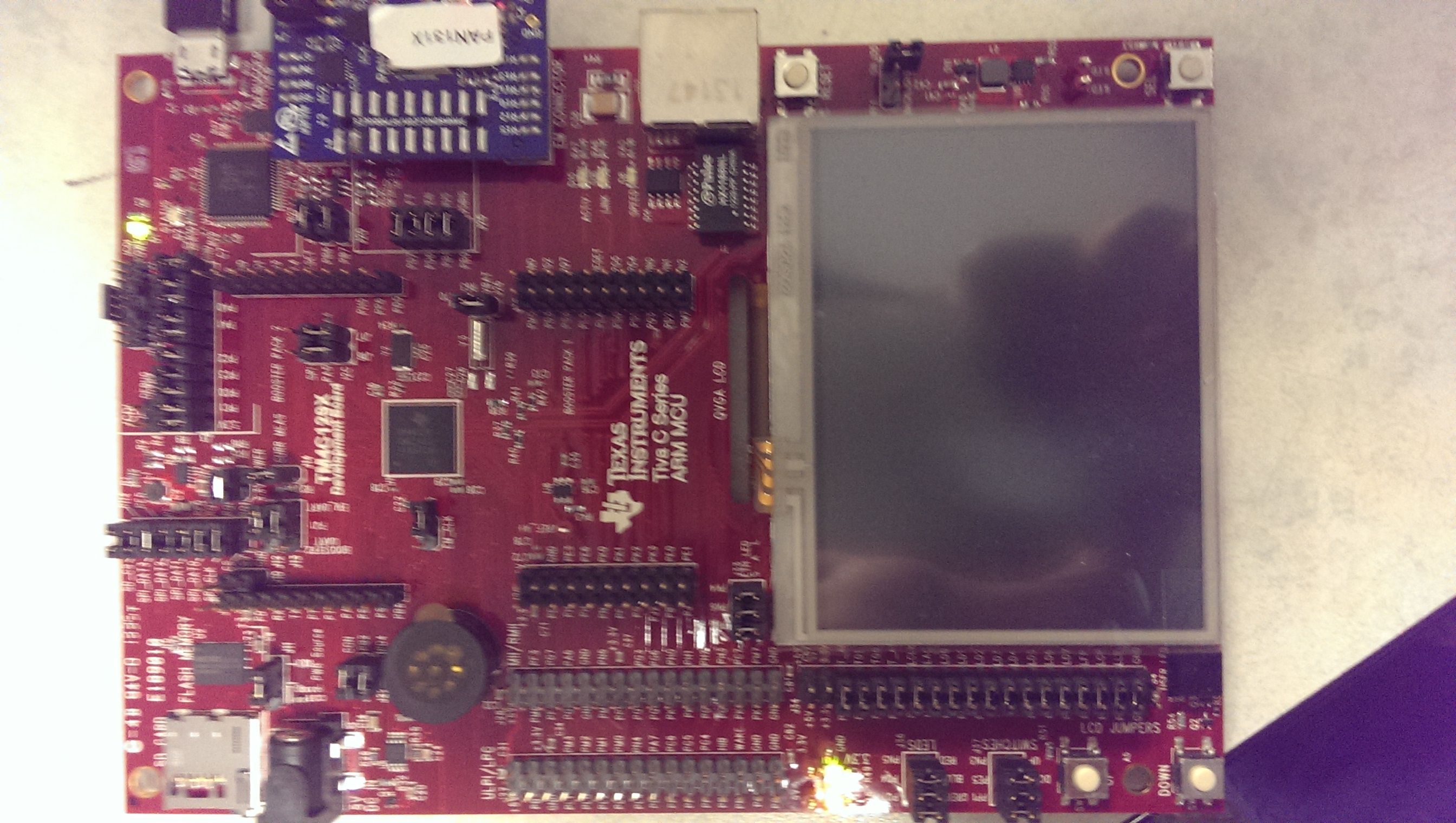

    I found some instructions in the ReadMe file from Bluetopia. It states that I need following jumper connections on Tiva TM4C129x  board to run the Bluetopia sample apps:
    J12 1-2
    J13 1-2 and J23 removed.  I followed this and then instructions on http://processors.wiki.ti.com/index.php/Stellaris_Bluetopia_Basic_Demo_APPS
    to build and download the SPP demo app on the Tiva board. I am using CCS IDE to run the app, after I click "Debug As" and Run, it gets stuck in a loop and does not return back to Main to toggle the LED.
    I am not sure if my jumper connections are wrong (setting J12 to 1-2 and J13 to 1-2 )
    Any help or guidance would be appreciated.
    Manasi

    I am actually still having issues getting the SPP demo to run on TIVA TM4C129x development board.
    I have followed instruction on the ReadMe for the demo and from the demo Wiki Page:
    With the following Jumper settings :
    J12 and J13  with Jumper between the middle pin and EM_UART as shown in the above picture, J23 jumper removed, as asked by the ReadMe, after I let the code download on to the board using Code composer Studio and run it, I see some messages going on the serial terminal (TeraTerm), it says "Stack Init Failed".
    I am still not sure if I am missing anything here? Also the Readme says Remove Jumper J23, but looks like in the picture you sent there is a jumper inserted on J23.
    What is the correct way? Could you send me the snapshot of the TeraTerm screen after the demo is working?
    Any help is really appreciated.
    Manasi
  • Manasi,
    I have the working TeraTerm screen attached. You shouldn't need the J23 jumper(It's actually not connected in the picture)).

    I finally got the stack initialization messages on TeraTerm and it shows me the prompt on TeraTerm where I can chose the mode to be server or client.
    I am trying to connect this device to an Iphone, so I have a the nblueterm App running on my iphone (equivalent to Blueterm on Android)
    These are the commands I entered on the teraterm window:

    Thanks for sending me the log.
    I tried flashing the code again and it still doesn't work.
    So this is some information on my test environment:
    I am using TIVA TM4C129x board with CC256x
    Jumper is removed on J23
    Jumper between PJ1 and EM_UART for J12 and J13
    I am running SPPLE Chat App on Iphone 5 with ios6
    Is your log based on similar environment? Also do i have to run any other commands before startscanning?
    Manasi
    The hardware is setup fine. We are using an iPhone 5 running iPhone 6.1.2 Can you tell me what PAN module you are using? You do not need to run any commands before startscanning.
    Stonestreet One.
  • I am using CC2456xQFN-EM Rev 1.2B
    Manasi
  • Manasi,
    Is the patch for 2564B defined in BTPSVend.c? If not, You will need to add #define _SUPPORT_CC256XB_PATCH__
    before the #ifndef __SUPPORT_CC256XB_PATCH__ in BTPSVEND
    Stonestreet One.
  • I added the #define but it still doesnt work.
    Would it be possible for you to share your project so that I can import it and run it as is just as a test?
    Manasi
    Can you post your email, We can email you the project.
    Stonestreet One.
  • Hi Stonestreet,
    Could you email it to me at mnavare@ti.com?
    Manasi
