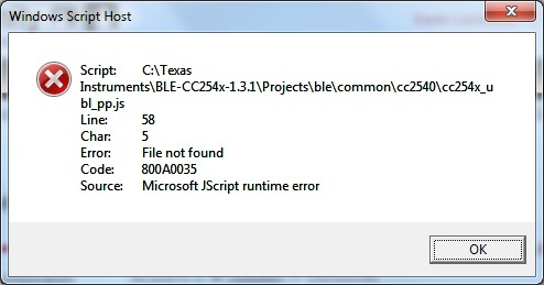

I'm following the OAD Guide for CC254x.  I keep getting a Windows Script Host error when IAR tries to run the cc25x_ubl_pp.js file at Compile time.  It says the file cannot be found.  I've triple checked the path in the Post Build Command Line.  I didn't any mention of this problem on the forums which leads me to believe this may be a corrupted file, but I've tries deleting/re-installing the BLE stack a few times to no avail.  Thanks guys.

  • The Post-Build Action does not show in the Build Window of IAR when I compile.  I simply get the Window Error prompt I posted.  My Command Line Post-Build Configuration in the project settings are as follows:
    "C:\Texas Instruments\BLE-CC254x-1.3.1\Projects\ble\common\cc2540\cc254x_ubl_pp.bat" "$PROJ_DIR$" "ProdUBL" "$PROJ_DIR$\CC2540-OAD-ImgB\Exe\TestFirmware_V1_ImageB"
    The folder in the last argument contains two files,  *.d51 and *.hex but no *.sim.   I omitted the step in the OAD Guide (Section 10 step 9) which selected the Extra Output option.  This always gave me a Fatal Error [e62]: File name "" used for multiple files.  Also I don't understand where a .sim file would come from as all the instructions advise to use intel-extended output file formats.  Thanks for your help
  • In section 10 in the OAD Guide you are just building the image and do not need to produce the .sim file. There is a note included below step 11 in section 10:
    "You may receive a post-build error. This is because you have not yet produced the .sim file. You can ignore this error
    at this point."
    You will need a .sim file for the over the air image you produce in section 11 but if you follow those steps you will produce a .sim file as output and should not receive an error.
