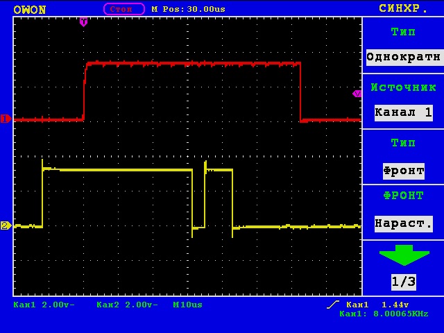

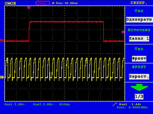

I have a trouble with PCM bus in bluetooth module LMX9838. I use PCM slave mode.
Module set data on Tx line before frame sync pulse start (approx 4 bit clock pulse).
Module parameters (slave):
CodecType - PCM slave. AirFormat - CVSD. PcmSlaveConfig - use slot 0, 1 slot per frame, 16 bit linear,  long frame sync, 16-bit data word length, use normal frame sync. Fcprs = 31.
Master parameters:
Bit clock 256kHz, 8kHz sample rate (frame sync), long frame sync, 16 bit.
Oscillograms:
channel 1 (red) - Frame sync, channel 2 (yellow) - module Tx.
channel 1 (red) - Frame sync, channel 2 (yellow) - bit clock.
Anyone have ideas about this?
