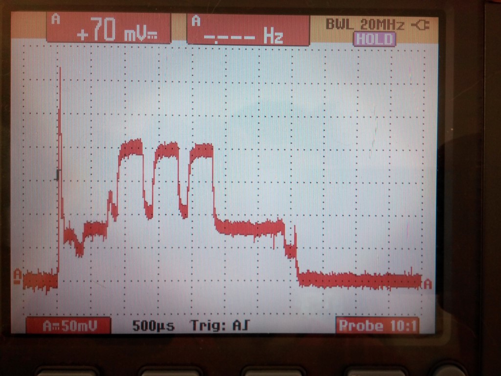

I have set up a CC2541 to advertise every second.
It has been configured as a broadcaster (non-connectable)
Everything works fine except the fact that watching the power consumption, it seems as if the CC2541 sends the data three times every advertisement (instead of one)
I have attached a screenshot of the power consumption.
Does anyone have a clue what's causing this behavior ?
Nir
  • Hi Nir,
    You are correct, the there are 3 advertisements. This is the way advertisements are specified in the SIG spec.  The 3 peaks are the same advertisement  being broadcast on the 3 advertising RF channels. In BLE , there are 40 channels. 3 are used for advertising, and 37 are used for data.
    You can take a look at following commands - advChannelMap, if power is main concern you can reduce channels used, but this will increase latency on any device looking for adv as they rotate through the same 3 channels when scanning.
    HCI_LE_SetAdvParamCmd
