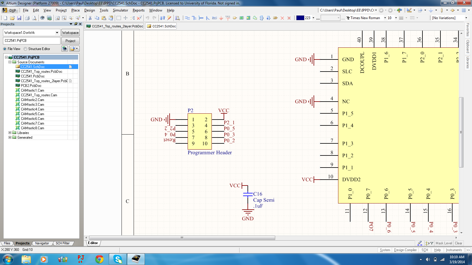

  • I tried programming the device today and I could not get the debugger to turn green. I also noticed that the debugger is not outputting the 3.3v on the bottom pin. I was not going to use this voltage but I thought it was weird it wasnt happening. The debugger seems to work fine when we plug it into the keyfob dev kit.
    We did have the programmer backwards in at first but the chip should be fine since i set a current limit on the power supply I was using.
    Any advice on moving forward? Is there a good testing method to see what the problem is. I checked and all of my connections are going to the right place and they are connected. Is there a way to tell if the chip was accidentally destroyed or not.
  • Hello Paul,
    If you post the schematic and you debug connections on to it i can have a quick look. Make sure that you do not have any dominating pull-up or downs that limit the debug interface from signalling correctly. For it to work you need to connect DD, DC, GND, VDD to the chip on VDD sense and Reset.

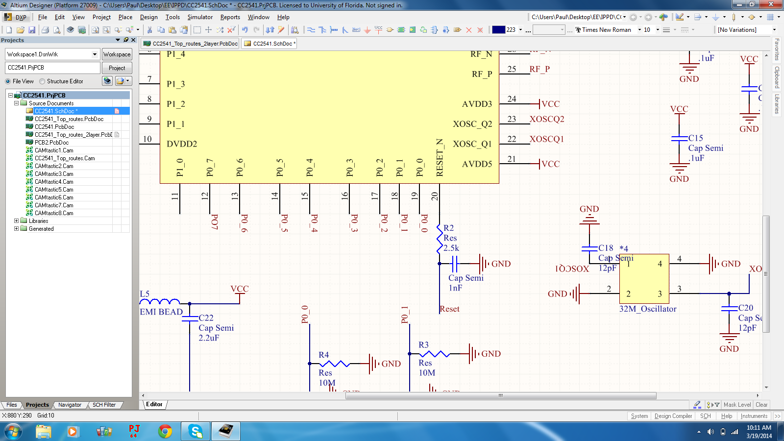

  • Attached are two schematics. The first is the wiring for the programmer. All of the pins are the same ones on the reference design and I have confirmed that they are all connected properly. The power on the programmer is the same voltage that is being seen on the chip.
    I also have attached the schematic for the reset. All of the connections except for the reset are going straight to the chip. For the reset I used the same connections show in the reference design. I did make one change though. We had lost our 1nF cap during assembly so I put a .1uF cap instead. I figured it was just to steady the signal, but I think I may have made a large time constant. Would this be the case for the failed connections. It may hold its charge too long and not discharge quick enough.
  • It might be the case. Try to remove the capacitor and try again.
