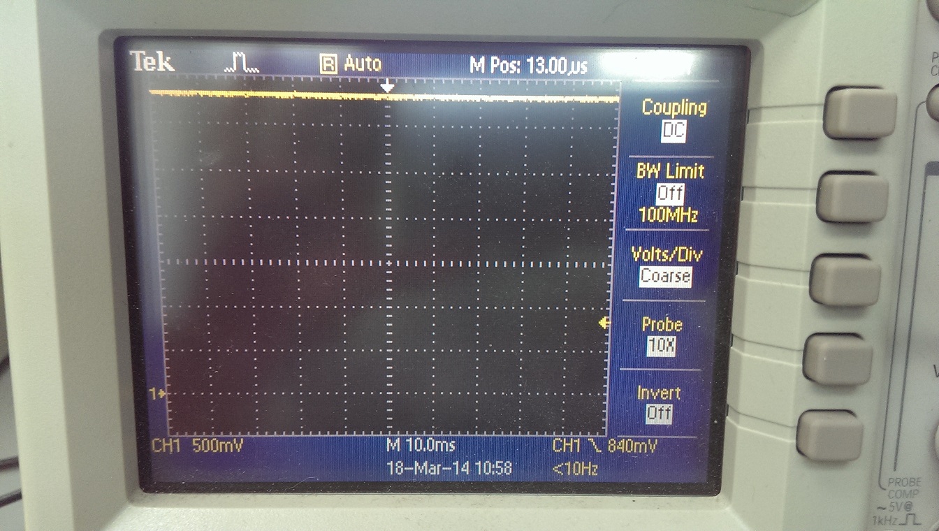

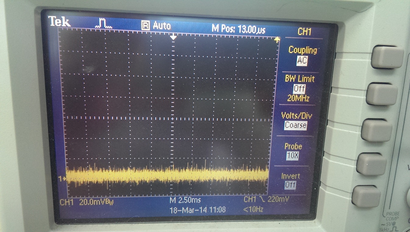

The power supply stability is captured below
AC coupled - 20mV/div
DC coupled 500mV/div
