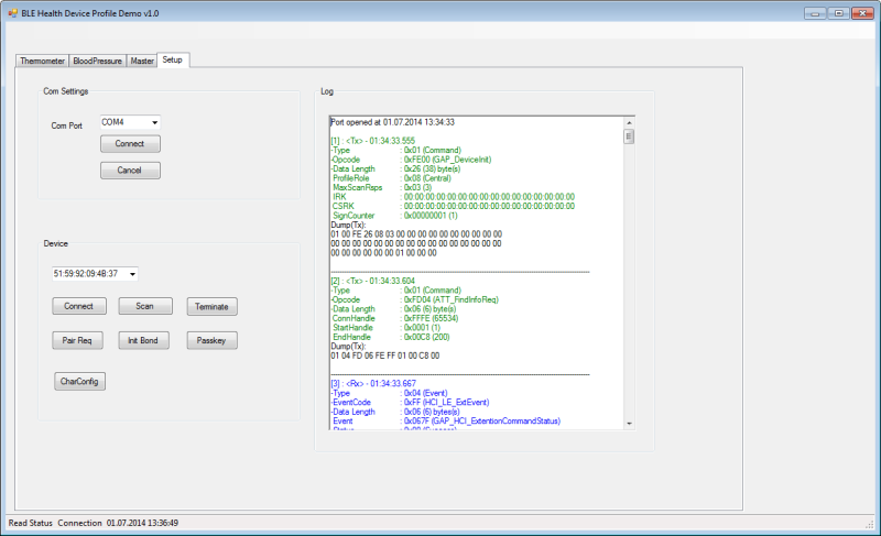

That is the correct image for the dongle.
I tested flashing a CC2540 dongle with the same image (from Accessories\HexFiles) in the 1.4.0 stack, power cycled the dongle and started the Health Demo application.
It shows up as COM4 and displays the BLE sniffer log in the Log window.
Using Win7 SP1.
Svend
