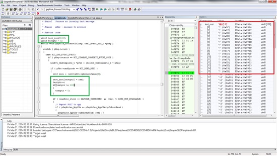

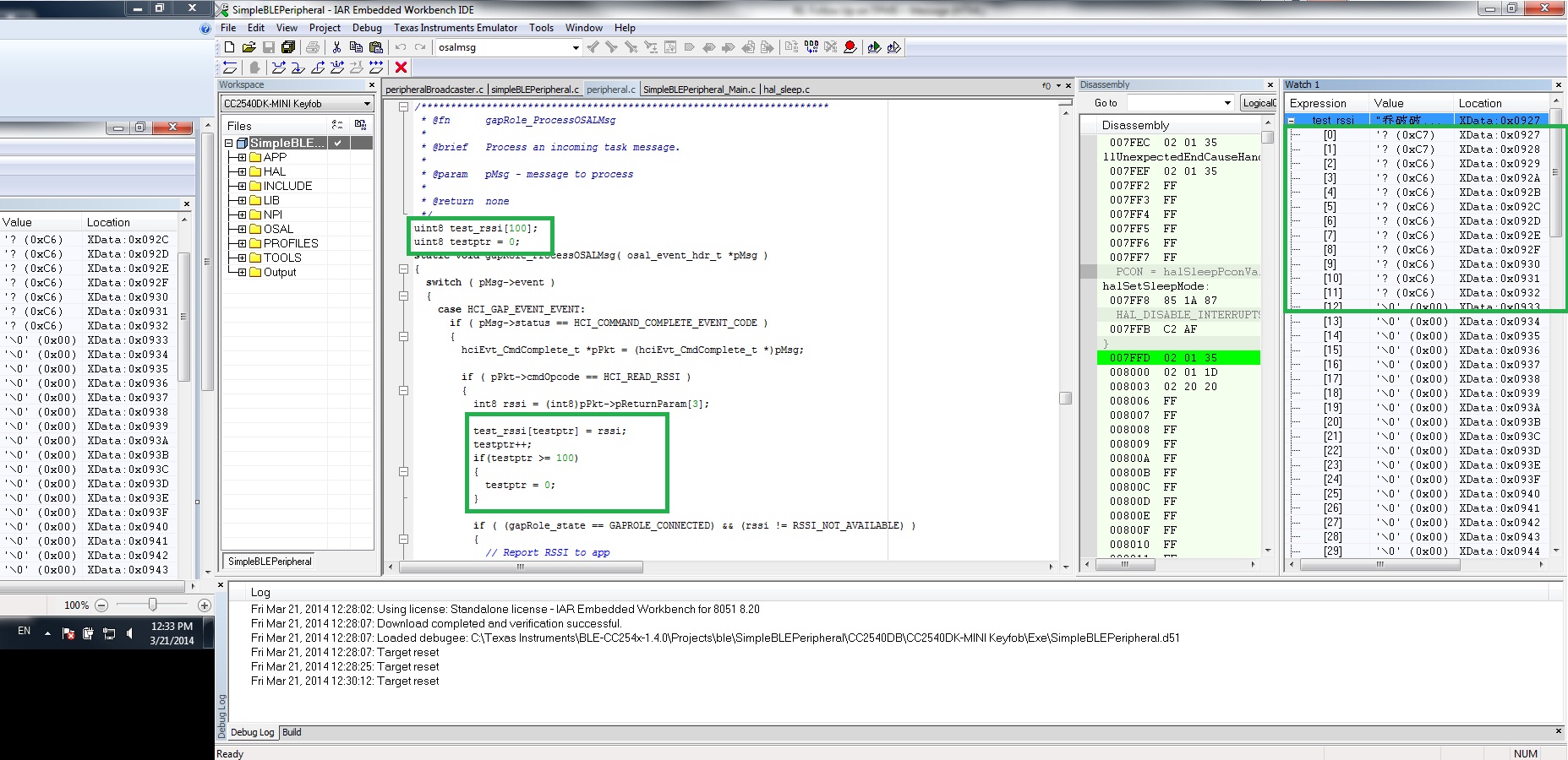

    Attach here with the test result’s print screen and the source code.
    1. To enable monitoring RSSI,
    Add the below code simpleperipheral when peripheral device is connected
                                    uint16 rssi_read_rate = 1000;
                                    GAPRole_SetParameter(GAPROLE_RSSI_READ_RATE, sizeof(uint16), &rssi_read_rate); /* In ms */
    1. In peripheral.c of stack 1.2 and 1.4,  Add the highlighted code in green for debug purpose. (.jpg)
    Highlight in green is the changes made in peripheral.c for debug purpose.
    Highlight in red indicate the result
    You will see that 1.2 stack manage to calculate the RSSI but 1.4 cannot. Any advise on this?

    uint8 test_rssi[100];
    uint8 testptr = 0;
    static void gapRole_ProcessOSALMsg( osal_event_hdr_t *pMsg )
      switch ( pMsg->event )
        case HCI_GAP_EVENT_EVENT:
          if ( pMsg->status == HCI_COMMAND_COMPLETE_EVENT_CODE )
            hciEvt_CmdComplete_t *pPkt = (hciEvt_CmdComplete_t *)pMsg;
            if ( pPkt->cmdOpcode == HCI_READ_RSSI )
              int8 rssi = (int8)pPkt->pReturnParam[3];
              test_rssi[testptr] = rssi;
              testptr++;
              if(testptr >= 100)
                testptr = 0;
              if ( (gapRole_state == GAPROLE_CONNECTED) && (rssi != RSSI_NOT_AVAILABLE) )
