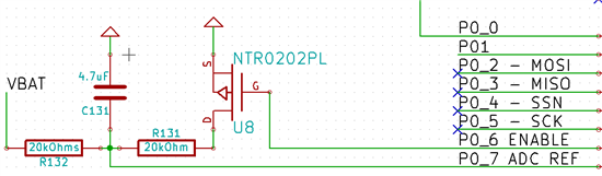

  • Hi all,
    I'm trying to do the same thing as James, except from the fact that I repalced the TSP with an LDO.
    My question is very simple: is there a reason James uses 2 transistors? Is it possible to do exactly the same thing with one mosfet, controlled with a GPIO Pin. The drain and source shall be connected to the GND and the Battery respectively. This seems simpler than two transistors, but if James did it I guess there must be a reason, which I am missing.
    Here is the scematic
    Thank you for your help!
    Artem
  • in your scematic,  S connected to GND, so G will be higher voltage than S, this will make it impossilbe to open the FET.
    to make it work ,you need N channel FET, you managed to make it work with a BSH103 MOSFET.
  • The NTR020 also won't work because if you look at page 1 of the datasheet you will see there is a diode between source and drain.  In your configuration the diode will always be active.
    An NMOS also won't work because when the NMOS is not active then the VBAT voltage will reach P0_7.  This will violate device operation since VBAT is higher than the supply.
