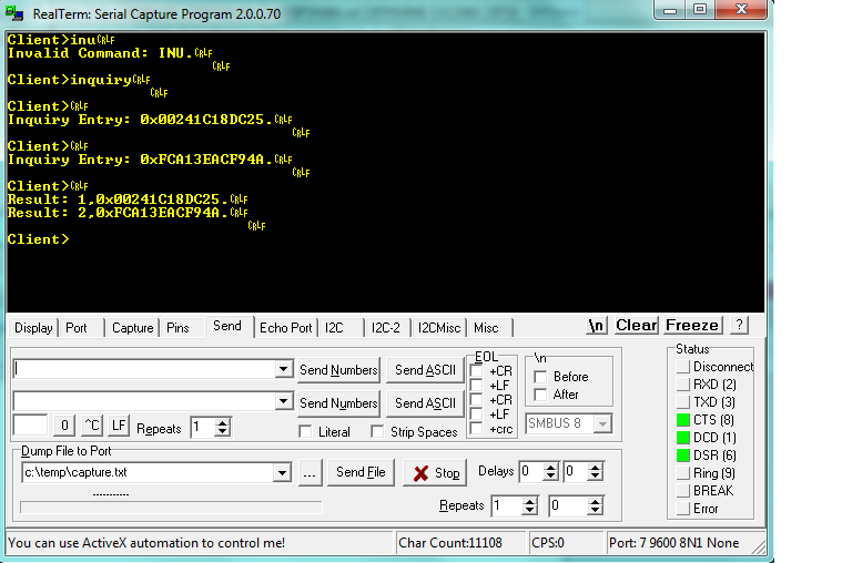

I am looking at the SPPDemo, compiled with IAR. I have both the MSP430EXP5438 & PAN1315ETU as well as a custom made 5438 & PAN1325A combination working (taking into account the different patch arrays)

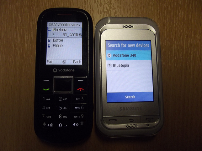

I believe the stonestreet bluetooth stack is working. I can run a client/inquiry and see 2 neighbouring bluetooth
cell phones as per the attached.
When I try to search from the cell phone the SPPDemo is not visible. I tried the "SetDiscoverability", "SetConnectability" but that doesn't seem to change the fact that device remains invisible. Why is that and
how can ensure the device is visible ?
