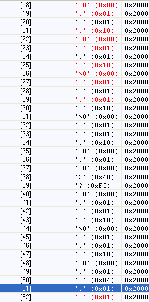

Now, I use STM32F4 and CC256x to make UART connection.
I have connected HCI RX/TX and nSHUTDN, and 3.3 V and add OSC1 on CC256x.
When I send the following command to CC256x using Uart
0x01 0x01 0x10 0x00
This command should be sent many items, we can get the IRQ, the receive the data is also not my expect data
0x04 0x0e 0x0c ......
So, is there anybody can give me some advice?
thanks

    Now, we can download SP and test RX/TX normally.
    But, when I send the command to CC256x. we have one problem.
    we will receive 0x00 data from CC256x always.
    please refer the log
    [21:11:35 ---] 00 00 00
    [21:11:35  22] 00 00 00 00 00 00 00
    [21:11:35  21] 00 00 00 00 00 00 00
    [21:11:36  23] 00 00 00
    [21:11:36  20] 00 00 00 00
    [21:11:36  22] 00 00 00 00 00 00 00

    I do not know why CC256x will reply 0x00 always, is there any opinion in your side?
    Note:
    In our side, we modify the port, because, the connection between RF1 and U3 includes problem, so we connect one cable to the Pin2 of U3.
    I use CC256x QFN EM board.
    Looking forward to your answer.
    thanks
    You are not using any stack and you just using the HCI commands to send data, correct.
    From the log you have provided all I see is you are sending version request and you are not getting any response. Just make sure you are probing the correct lines.
    This is strange you were able to test RX/TX normally. So there should not be any problem in the communication.
    Can you try loading the SP using Bluetooth Hardware Evaluation Tool(BHET), after that with out resting the board close the BHET. and start you HCI command interface and send some HCI command lets say enable scan and see if you are seeing any response(or you are able to search for this device from any remote device)
  • thanks for your suggestion.
    But, in my side,  our hardware can not pass BHET now.
    when I try to loading the SP, Com port timed out will happen.
    I have checked the waveform of nSHUTD, HCI_RTS, there is no problem.
    And check the signal of HCI_RX_1V8, we can see the data. but there is no reply from CC256x and BHET is fail.
