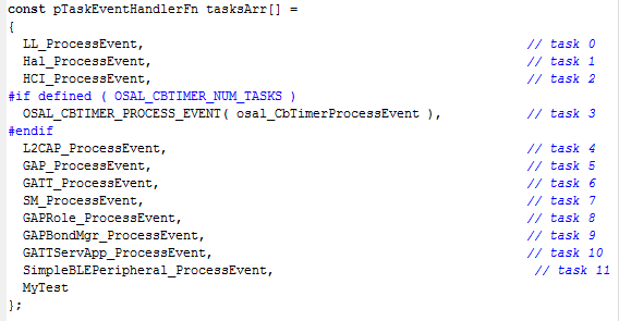

Basically, I've got two OSAL application tasks, and whichever one has the lower priority never seems to process events.
I've got a CC2541 that I'm working with, and I believe my project started life as the SimpleBLEPeripheral.  The main application task sets up all the bluetooth stuff and then calls osal_set_event on itself to start advertising after initialization.  It was working fine until I added a second application task to handle blinking LEDs and whatnot.
Added the ProcessEvent function to tasksArr[], and added the Init function to osalInitTasks(), making sure they were both in the same order, right above the main application task in priority.  Again, at the end of the init function, the task calls osal_set_event on itself to light an LED signifying that the board has started up.
At this point, the LED worked, but bluetooth never started advertising.  If I swapped priority on the task list (in both the array and the Init calls), then bluetooth would advertise properly, but the light would never come on.  It's not a matter of either task never completing, because the board continues to process events at later times.  And since both work on their own, I don't understand why it's like the second one doesn't exist when they're both present in the code.

  • Here's my task array:
    // The order in this table must be identical to the task initialization calls below in osalInitTask.
    const pTaskEventHandlerFn tasksArr[] =
      LL_ProcessEvent,                                                  // task 0
      Hal_ProcessEvent,                                                 // task 1
      HCI_ProcessEvent,                                                 // task 2
      OSAL_CBTIMER_PROCESS_EVENT( osal_CbTimerProcessEvent ),           // task 3
      L2CAP_ProcessEvent,                                               // task 4
      GAP_ProcessEvent,                                                 // task 5
      GATT_ProcessEvent,                                                // task 6
      SM_ProcessEvent,                                                  // task 7
      GAPRole_ProcessEvent,                                             // task 8
      GAPBondMgr_ProcessEvent,                                          // task 9
      GATTServApp_ProcessEvent,                                         // task 10
      BLEDevice_ProcessEvent,                                           // task 11
      LED_ProcessEvent                                                  // task 12

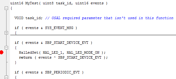

    The LED init:
    void LED_Init( uint8 task_id )
      LED_TaskID = task_id;
      osal_set_event( LED_TaskID, LED_CYCLE_EVT );
    And finally the LED event processor:
    uint16 LED_ProcessEvent( uint8 task_id, uint16 events )
      VOID task_id; // OSAL required parameter that isn't used in this function
      static uint8 led_cycle_state = 0;
      if ( events & SYS_EVENT_MSG )
        uint8 *pMsg;
        if ( (pMsg = osal_msg_receive( LED_TaskID )) != NULL )
          LED_ProcessOSALMsg( (osal_event_hdr_t *)pMsg );
          // Release the OSAL message
          VOID osal_msg_deallocate( pMsg );
        // return unprocessed events
        return (events ^ SYS_EVENT_MSG);
      if ( events & LED_CLEAR_EVT )
        ClearLEDs();
        return ( events ^ LED_CLEAR_EVT );
      if ( events & LED_CYCLE_EVT )
        switch ( led_cycle_state )
          case 0:
            ClearLEDs();
            SetLED(RED_LED,ON);
            break;
          case 1:
            ClearLEDs();
            SetLED(YELLOW_LED,ON);
            break;
          case 2:
            ClearLEDs();
            SetLED(GREEN_LED,ON);
            break;
        led_cycle_state++;
        if (led_cycle_state > 2)
        if (led_cycle_state)
          osal_start_timerEx( LED_TaskID, LED_CYCLE_EVT, LED_CYCLE_EVT_PERIOD );
        else
          osal_start_timerEx( LED_TaskID, LED_CLEAR_EVT, LED_CYCLE_EVT_PERIOD );
        return ( events ^ LED_CYCLE_EVT );
      // Discard unknown events
      return 0;
    If I keep the task array in that order, START_DEVICE_EVT occurs and the LED_CYCLE_EVT never happens.  If I switch the order of BLEDevice_ProcessEvent andLED_ProcessEvent in tasksArr[], and their init functions in osalInitTasks, then the LED_CYCLE_EVT occurs, but START_DEVICE_EVT never happens.
