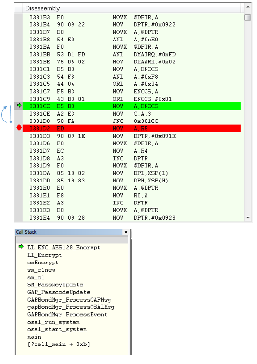

As I mentioned, it appears that the devices are getting hung after pairing has successfully started.  Using the debugger I set breakpoints at the following highlighted locations:

I found that the first breakpoint was hit (meaning that I am using the default passkey), but the second breakpoint was never hit (meaning that GAP_AUTHENTICATION_COMPLETE_EVENT was never raised.
I've also determined that GAP_TerminateAuth is never called meaning that either GAP_PasscodeUpdate was successful or it never returned.

Do you have any suggestions on how I can troubleshoot this issue?
