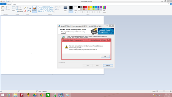

2) I downloaded SmartRF Flash programmer 1.12.7 to program the CC2540 USB dongle. During installation i get the following error.
 One o
When I ignore I get couple other errors in regards to CCdebugger.inf etc file and then finally finishes the installation.
When I opened the smartRF flashprogrammer (inspite of errors during installation), I couldn't find the CC2540 device on SmartRF Flash programm devices list.

  • As the other posters have pointed out, the dongle needs to be powered separately for the debugger to detect the CC2540 device. Note that the debugger operates entirely independently from the host during the chip detect phase, so it should be able to turn the green LED on despite any driver issues on the PC. the only exception would be if you're using a debugger with *very* old firmware, which didn't know anything about the CC2540 device.
    The errors you see during installation can be ignored. The installer tries to install unsigned drivers (.inf files missing .cat files). Win 8.1 is enforcing a stricter driver installation regime than Win 8, but we haven't updated the installer to reflect that (yet).
    Nevertheless, the correct signed driver will also be installed, so the tool should work just fine on Win 8.1.
