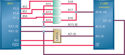

Why does port 2 only go from [0:4] when we have an 8 bit processor and ports 0 and 1 are [0:7]?
My assumption is that they are sacrificed to create the banked memory model that compensates for the 8051 tiny 16 bit address line.
