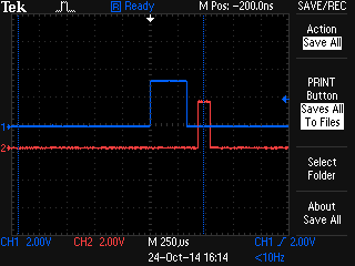

    The CC2590 EN and PAEN  pins seem to do what they should (scope screen capture attached; EN is blue, PAEN-is yellow; CC2541 shown; as measured at R122 and R132.)
    The HGM enable line (pin P1.1 on the CC2540/1; pin 7 on the power amplifier) stays low, even when the signal between the two boards is attenuated to an extent that link performance would improve with additional receive gain.  Even so, no additional LNA gain is ever requested by the CC2540/1.
    Question: Is there a way to enable automatic control of high receive gain by the CC2540/1?
