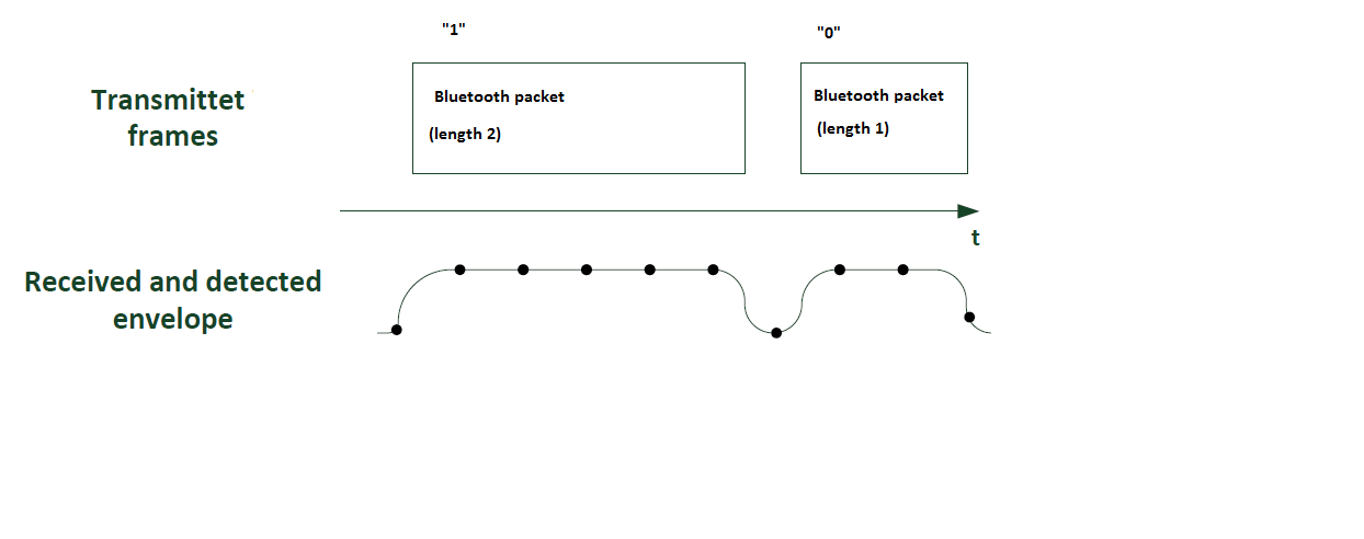

Hello TI experts,
I am going to use the CC2541 Development kit in order to program a simple broadcaster which is able to transmit a multitude of different advertising PDUs. Therefore the duration between the consecutive packets shall be as small as possible. I know that the duration of two consecutive advertising events is in the scale of some milliseconds, which is to much for my application.
Is it possible to transmit more than one packet within one advertising event e.g. with a inter frame space of a few hundred micro seconds ? And if not, is there any other way to realize a higher "packet rate" of advertising packets ?
I really hope you can help me :)
